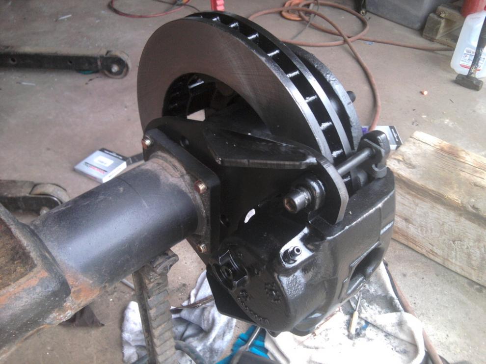

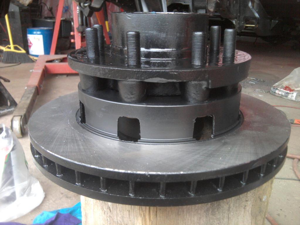

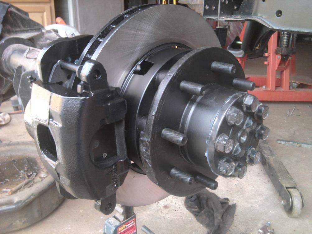

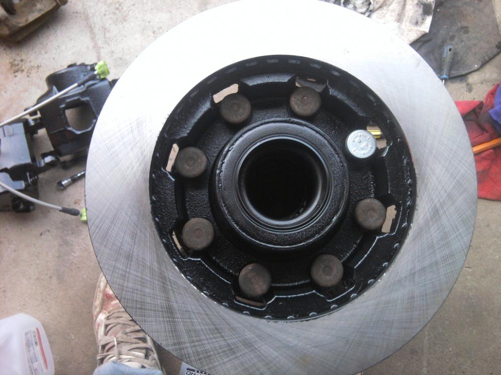

i am doing it right now i got my axle stripped today an bolted the brackets on
i will get pictures and post them tommarow
kleedus
Jan 25, 2012
1,726
164
wyo
Ray
1960 threw 91
c10 to k30
350 threw 454
does these pic cover your questions

Between the pics and your description i have it all figured out and completed the conversion thanks for all the tips.
