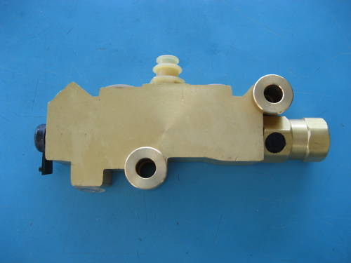

disc brakes have 2 pounds residual pressure and drum brakes have 10 pounds so you will need a proportioning valve
i just bought one of these look more on ebay i found some cheaper
http://www.ebay.com/itm/gm-car-prop...Parts_Accessories&hash=item2a25213ee4&vxp=mtr

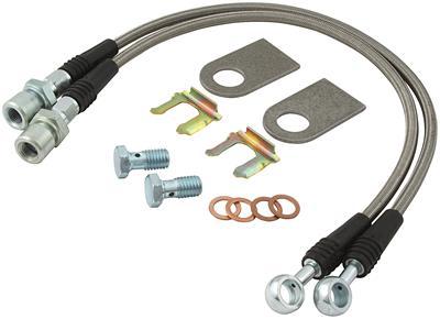

and i got these brake lines i am going to mount the tab to the spring perch and run hard lines from the tee to them
http://www.ebay.com/itm/Allstar-ALL...t-/330819258839?forcev4exp=true&forceRpt=true
