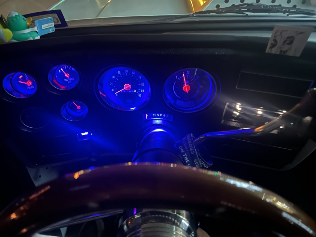

#168 bulbs in the dash lights will be brighter by 50% (3 candlepower instead of 2) than the #194 that are probably in there. That's how we did it, back in the day, before LED bulbs were a thing.
Randy and Easton
Feb 6, 2021
901
1,330
North Richland Hills, Texas
Randy
C-10 LWB
