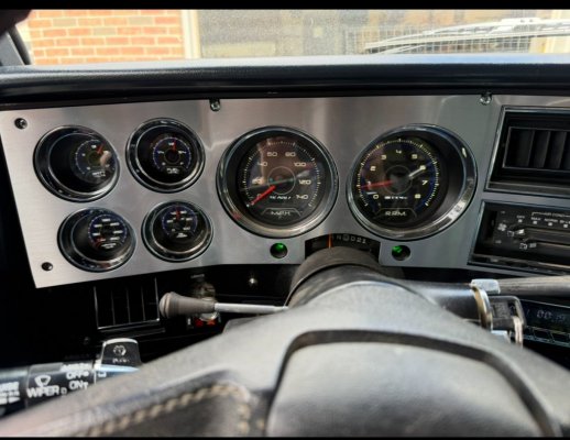

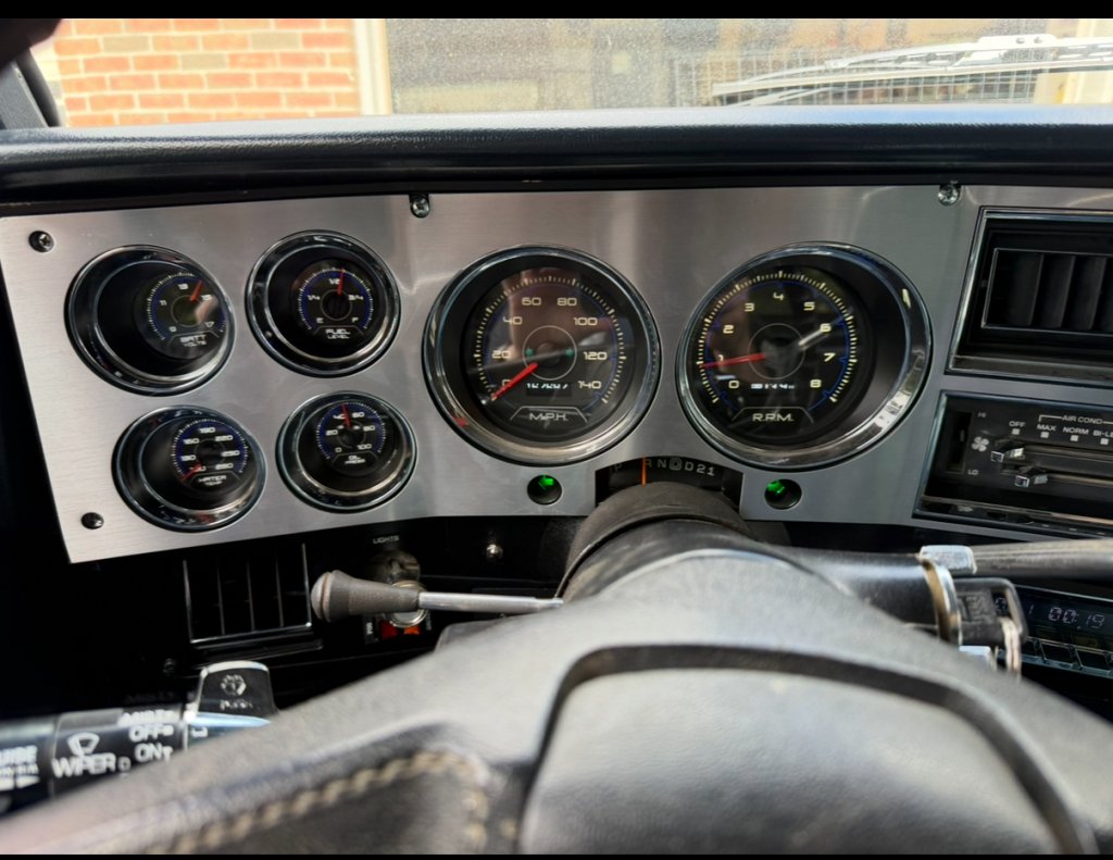

I used a New Vintage. It actually Looks great, but I had to have the tach replaced 4 times before it finally work correctly. It would burn out everytime after 3-4 hours of use. Yes, that means pulling the entire dash apart 4 times. Speedometer also slaves the oil pressure gauge and when the oil pressure gauge quit working, that meant a new spedo, so that was a 5th R&I. The dash mount is kind of junky and it took like 10 moch-ups to get them all in the window in the center without a gap. Ignore the glow on the parking lights. That is from the LCD bulbs, it has nothing to do with the dash.
In retrospect, I should have went with a Dakota Digital, but it has been about a year without any more gauges burning out or issues, so hopefully I have taken it apart for the last time. New Vintage customer service was great, and didn’t argue about any replacements, but I am not sure I have forgiven them yet for making me do that job 5 times.
All the wiring was extremely manual and you have to extremely detail oriented. I didn’t see the adapter when I bought my kit 3 years ago, so a lot of cutting soldering and shrink wrapping. I had to add relays to make the parking brake, oil light and 4 wheel drive lights on the dash work. Seems like a plug and play option was just within reach for them to complete and they decided to just give you 20 pigtails instead. Instruction diagrams were good, I did find some mistakes in the instructions and I had to call them to make sure I was right and they were wrong. (I was)

Id pay 1.5x to not redo it 5 times thats for sure

Well the results look great, so I'd say it was worth the effort, but I also didn't have to do it :lol:
