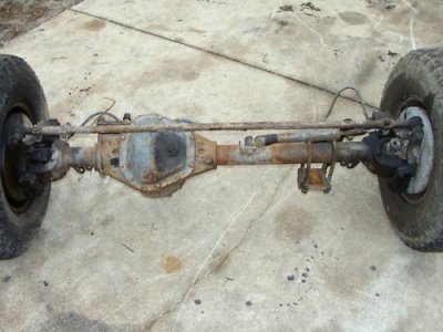

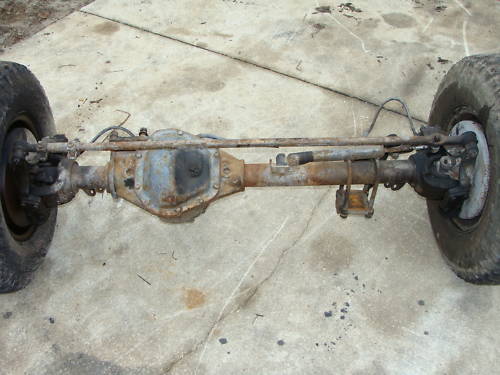

I assume you are talking about GM front axles Pops??? They are very obvious between the Dana 44 and Dana 60. Biggest difference is size of course. They aren't even close in physical dimensions. Here are a couple pics of Dana 60 fronts I have on my computer. These happen to be of a CUCV Dana 60 Front Axle.

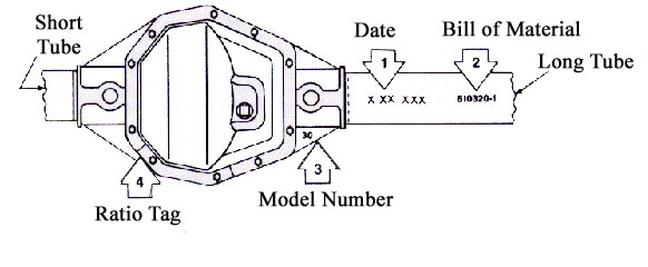

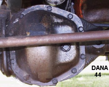

Its not much, but here is a pic of a Dana 44 Front I found on my computer, and another diagram of the ID layout for Dana's.

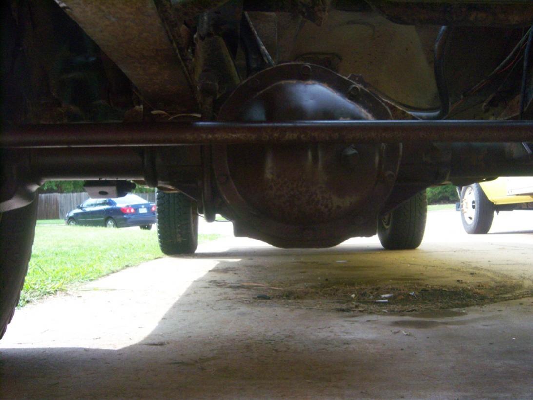

Just for comparison, here is a pic of a 10bolt front. Same thing you have on Old Blue except Blue probably has a wussy gear ratio and 6 lug hubs.

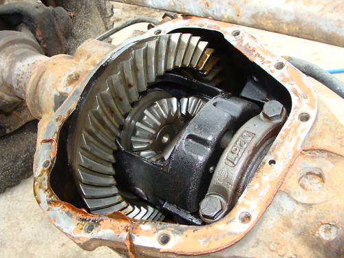

Here's the inside of the 10 bolt.
