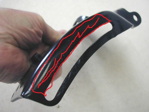

I think this thread should be renamed from 130 amp upgrade to Alternator Upgrade lol.
I got my hands on a CS144 this weekend and despite what people say it isn't that hard to install. The two things to keep in mine..
1) Either create your pigtail or buy one.
2) You only have to modify the bolt slot and essentially you remote all the material and then loosen the bolts for the bracket and slide it in.

Or put washers under the bracket on the intake. How is it going so far?
I'm using a aftermarket intake. If I put washer under there then it would increase the distance the bracket requires to bolt to the water pump.
I have a bunch of wiring I'm going to need to upgrade but I have a bunch of 4g wire I'll be using.
I will also look into using a turnbuckle style to see how that works too.
