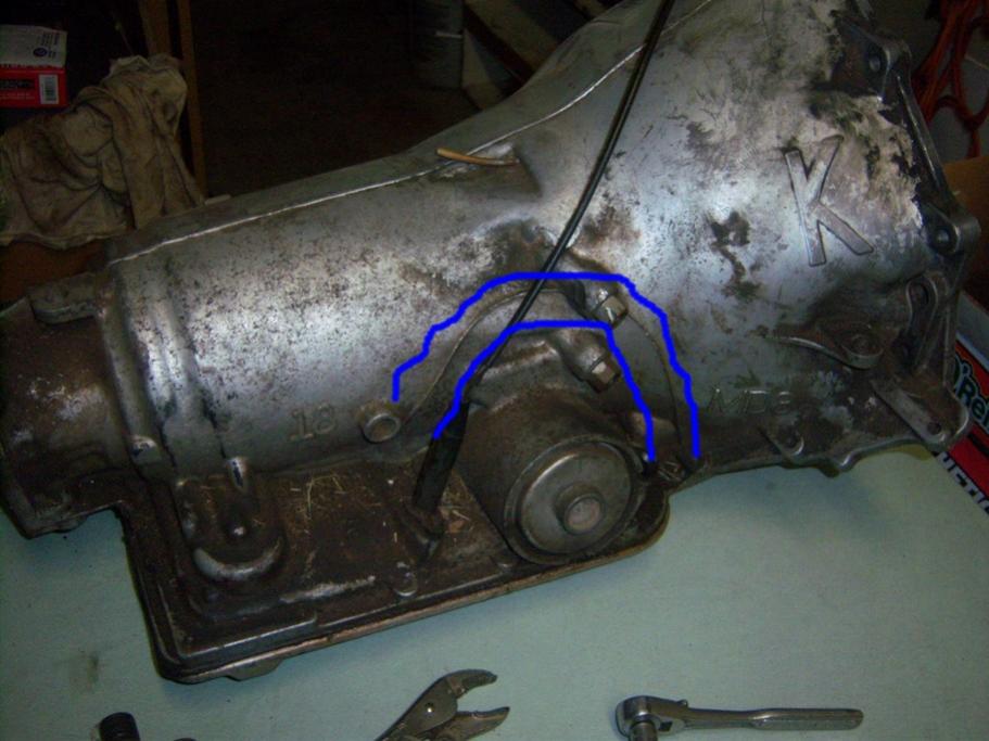

BTW, here is another tell tale sign of the good or better 700r4. Look for the rainbow shape sprue or flashing on the passenger side.
attachment.php
attachment.php
Good info! :waytogo:
