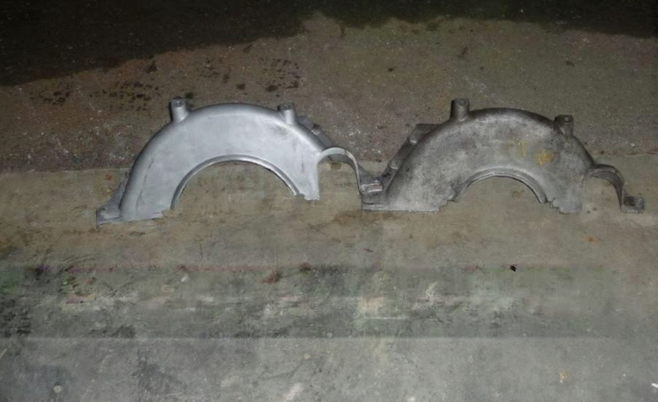

If you go 4L80, you may run into convertor dust cover issues. 99.5% of 4l80 came behind BBC. the oil pan arc area of the cover is much larger.

I swapped in a 4L80E in place of my TH400 (C20 Suburban). I used a US Shift Quick 2 controller- easy set up and works like a charm. I modified my TH400 dust cover to fit the 4L80E by drilling new holes. Best upgrade I've done. Night and day.
