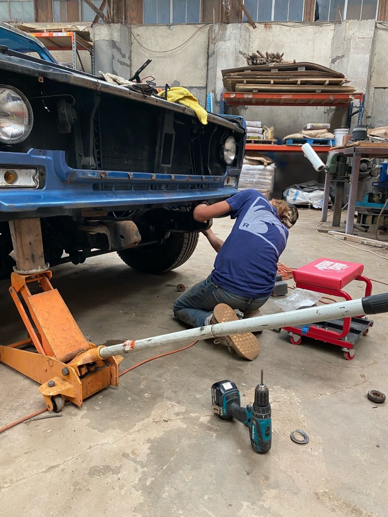

We were lucky with ours and lots of soaking Ken and finally came off. New bolts came in out kit with cab supports.
