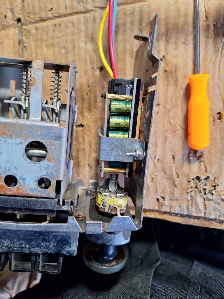

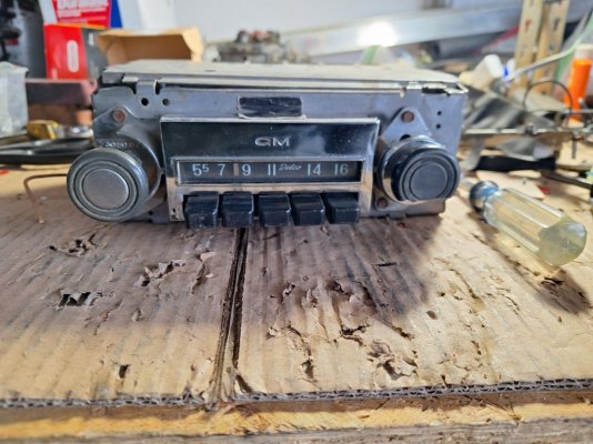

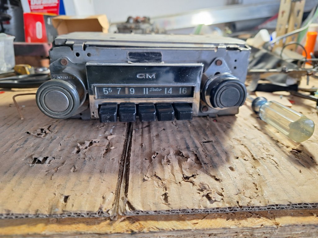

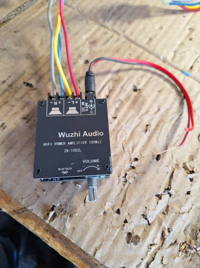

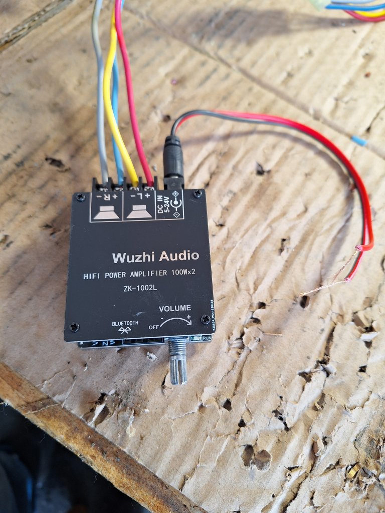

I just converted the factory AM radio in my 70 C10 to Bluetooth using a $20 Amazon Amp. I gutted the old radio and mounted the Amp so the original on/off/volume rheostat would control it. Someone else had the idea you could just wire the Amp to the power wire for the radio so it would come on any time the ignition was on and then control the volume with your phone. I wired it to a battery and some old speakers and the volume and sound quality sounded good to me.

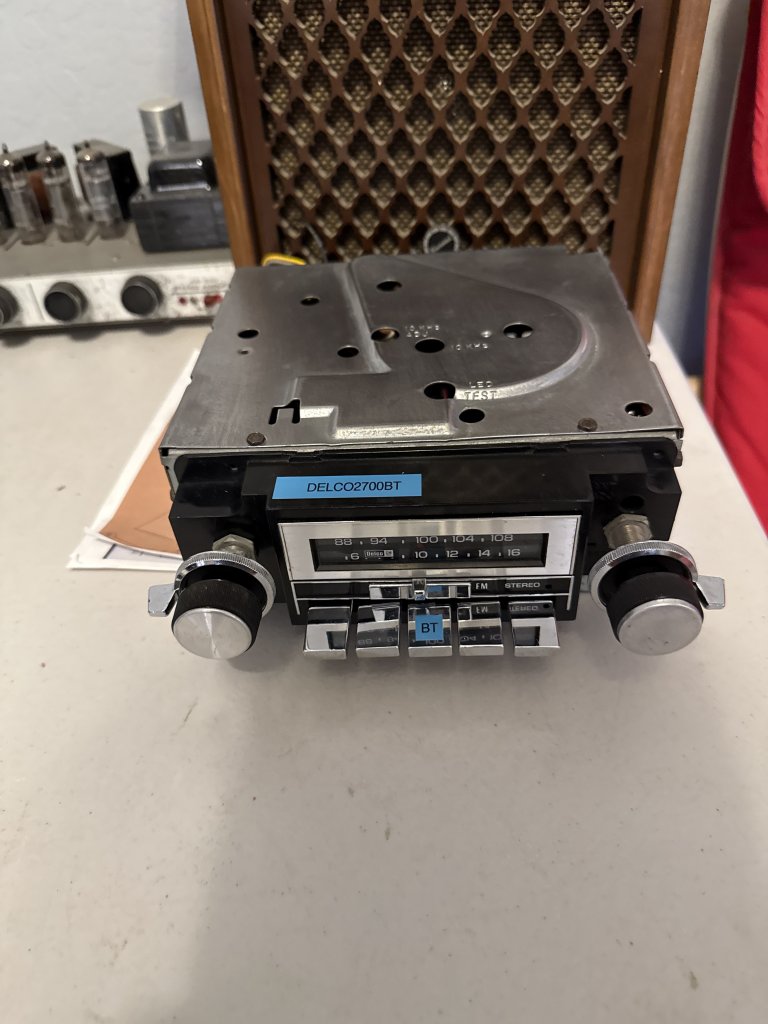

I add Bluetooth capabilities to square body delco 2700 radios. AM or AMFM. I use the middle preset to turn on and off the Bluetooth module inside. With this option you can play any streaming service through your factory radio. Your radio retains all of its original circuitry and looks 100 percent original. When not using the Bluetooth it plays normal radio AM or AM FM. Most customers I have done this for only use it for music playback but I can add an external mic for hands free calling too. When you get your radio back it will look like this. Send me a message for details. Jim
