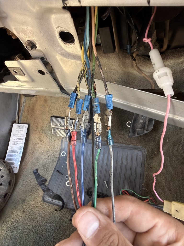

hello, I’m trying to install a new radio for my truck and the previous owner hacked up the wires to the radio. I am just trying to figure out what wires to use. It has two dash speakers and two rear speakers. Anything will help thanks

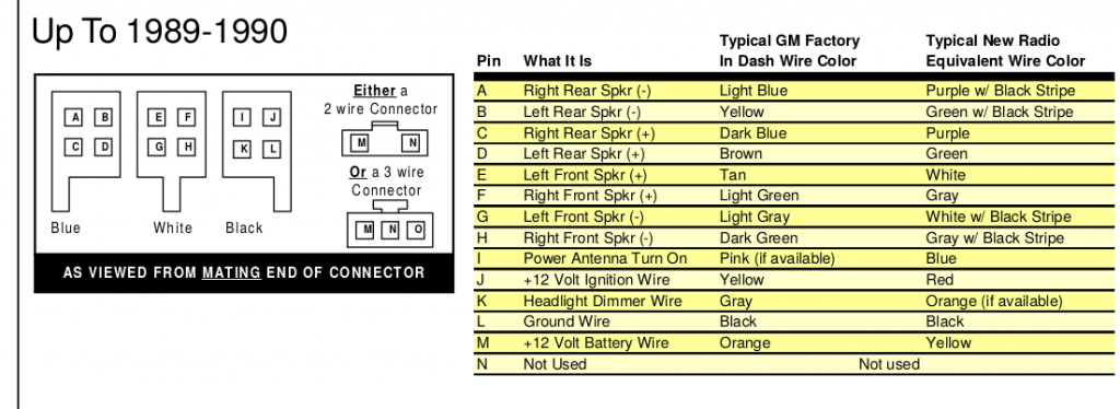

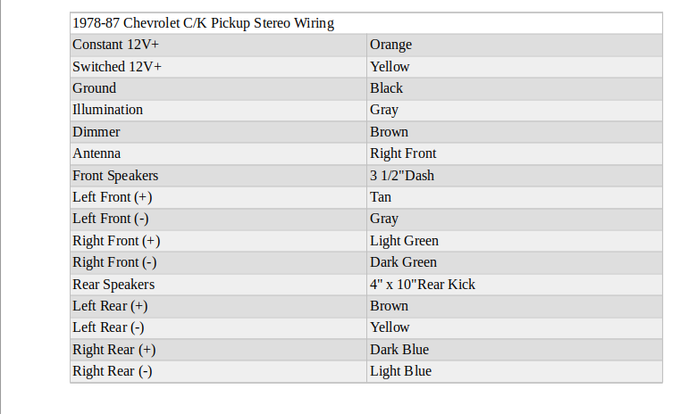

These attachments are better than the diagram I posted
Wish I would’ve saw this earlier lol took a look at this diagram after I finished rewiring. Did all of the wrong wires… Ended up fixing the courtesy light under the dash lol. Thank you I’ll probably just cut the connections off and rewire them tomorrow.
