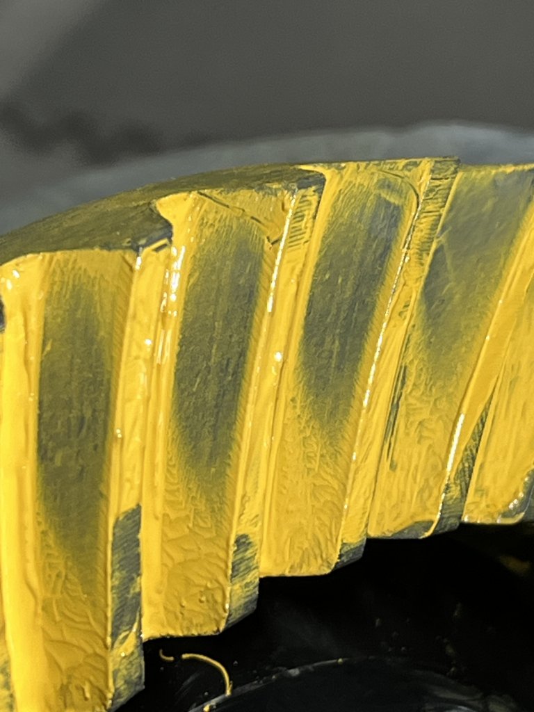

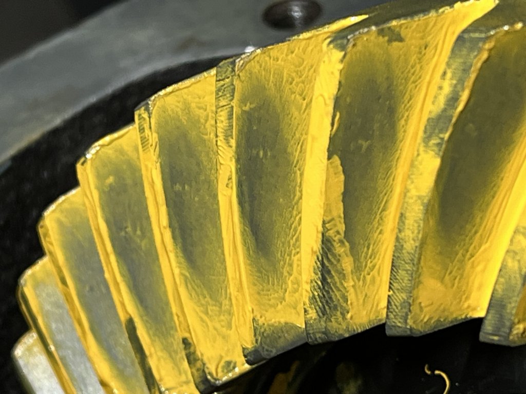

I am setting up a new ring and pinion in my '73 K10. This is the Dana 44 in the front. The original gears were 3.08, the new gears are 4.11. I think the pattern looks OK but I could use some comments from people with more experience. The backlash is at 0.010". I still need to set the pinion preload, hopefully that won't change the pattern. I do have preload on the pinion but the nut is not torqued to 200 yet.

It needs to be more centered on the teeth in my opinion. So more pinion depth, doesn't need a whole lot. Also get a beam style torque wrench, the torque spec is just a general guideline. You need to measure rotational force of just the pinion to set preload.

By centered on the teeth do you mean heel to toe (end to end) or face to flank (top to bottom). Terms used in the Yukon book that came with the ring and pinion, or master install kit, I don't remember which.
I do have a bean type torque wrench as well as clicker torque wrenches. The rotatin torque on the pinoin after I added shims is about 20 inch pounds with the pinion nut torqued to 250 ft. lbs. This is without the pinoin seal installed. My Yukon book says it should be 14 - 19 inches and the factory manual says it sould be 20 - 40 inches with new bearings. The Yukon book says the torque on the pinion nut would be 200 to 400 depending on the size. The shop manual says it sould be 250 ft. lbs.

End to end, I would like to see the teeth setting closer to the middle of the ring gear. One side does look better than the other, the 2nd pic. The shop manual may call for more initial, to counter the bearing getting broke in. 15-20 sounds about right.

Kind of looks like your pattern is walking in the first photo. Did you check the run out of the ring gear?
Good point, I will check it this morning.

I added 0.002" to the pinion shims. I have 20 inch lbs preload on the pinoin. The backlash is now 0.009", spec is 0.006" - 0.010" so I am ok there. I checked the runout on the ring gear, it is about 0.001". The manuall says up to 0.006" is ok. Below are a couple of pictures of the pattern as it stands now. I am going to give this a shot, hopefully it works.
