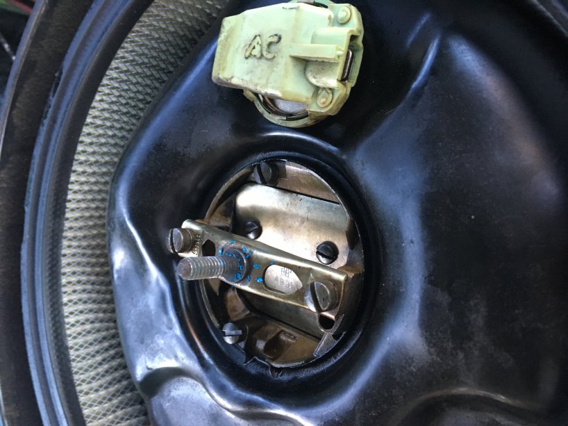

Remove the air cleaner and manually open the throttle all the way. Observe what the choke plate does and report. It should drop all the way closed. If it doesn't the linkage may be gummed up or it may be out of adjustment. Some close up pics will help too. There is a vacuum pull off that is meant to pull the choke plate open a bit once the engine starts. Make sure the line to it is ok and that it moves in and out.

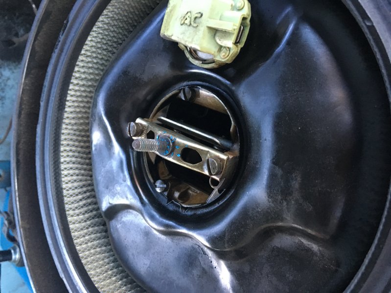

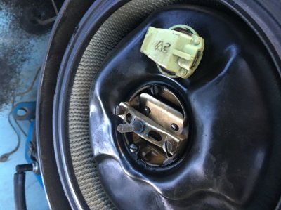

OK I went out this morning to check it out. It was 36*. I think I figured it out. Usually I get in the truck , kick the gas pedal 2-3 times and start it up. I seem to remember reading somewhere that the gas pedal should be pushed 1 1/4 times before starting the engine. Today I pulled the air cleaner cover and the plate was wide open (first pic). I pushed the gas pedal one time and the plate closed all the way (second pic). I started the engine and the plate opened just a little (pic 3). There was none of the previous problems. The engine rpm's held steady at a reasonably low rpm.Then after a minute or so the rpm's starting increasing a little until it hit a stable high rpm. Once the engine temperature gauge needle started going up I kicked the gas pedal again and it went back down to the low idle. Is it possible that pushing the gas pedal more than once could have been causing the problem?

You should only have to kick the pedal once to set the choke and fast idle, and to squirt a little gas into the carb. Then you can kick it again if the engine won't start. Kicking it several times could flood the engine a little, but the idle should recover in a few seconds after the excessive fuel is burned.
Try the procedure that worked for you, but do it with the air cleaner top installed. If the problem returns, you may have another issue, for example a crushed hot air pipe that runs from the snorkel to the exhaust manifold.
