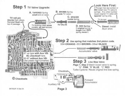

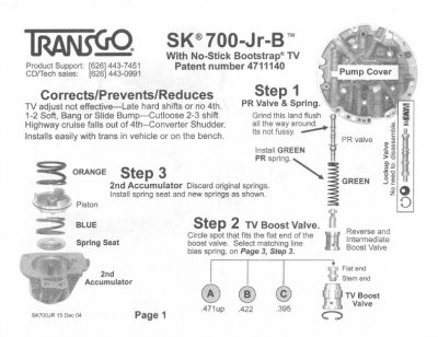

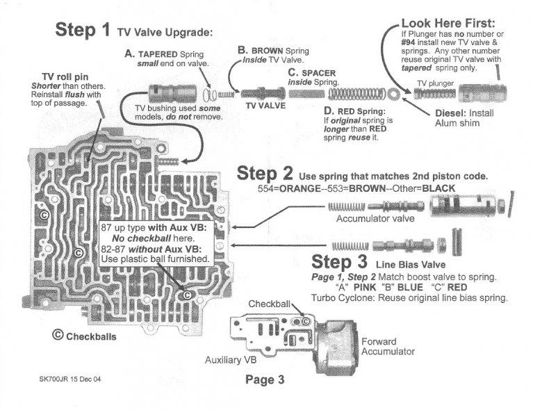

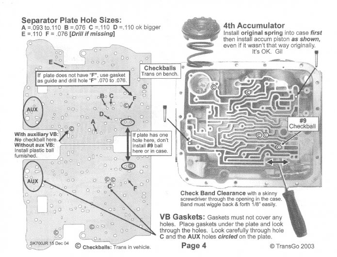

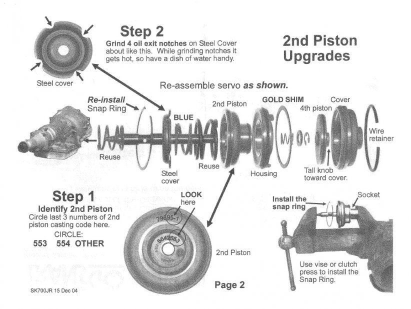

Scanned the instructions for the Transgo 700 JR kit:
