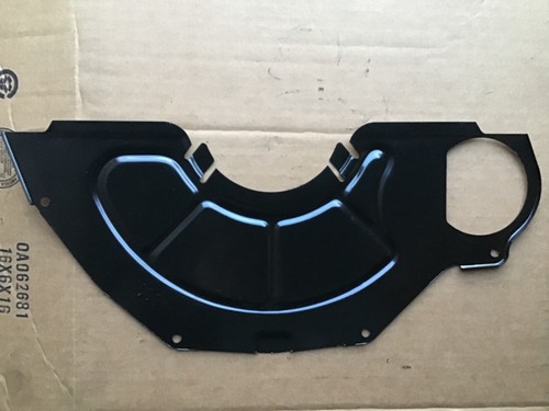

If you go to the 12" check you have the correct bellhouse to accomodate the bigger clutch.
See the 4 to 8 o'clock position has the big step for the bigger clutch. These come in hydraulic or mechanical setup.
my replacement inspection cover is too small, I would now guess that this is why....any chance you have a part # or know of where a reasonably priced replacement (no original) can be found...thanx in advance

Yeah I had the same problem, I bought an aftermarket one and trimmed and redrilled the holes in the plate for it to fit. Not what I wanted to do, but I couldnt find the part number either!
I think it was this Pn 6263757 ? for bellhousings, 460486 and 6262756 bell housings.
Here is a fleebay listing as an example;
