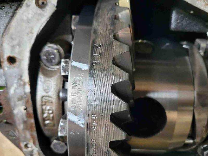

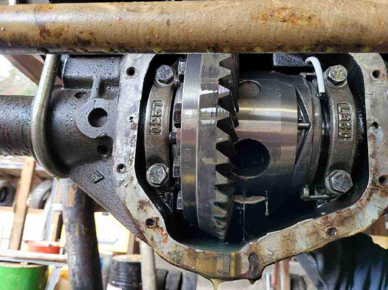

Can anyone tell what kind of diff this is? Open? locker? They say it’s hub to hub 8 lug. $400 plus $800 shipping to my house

Looks like a Dana, as it has the spreader holes, D60 fronts are rare, wish I had one too, so it is most likely a D44. Make sure it has the right side drop so its compatible. My K20 has one, I like it, it is behind a big block. Here is the build if you want to check it out.
nvrenuf
2,198
3,051
Mobile, Al.
1991
Sorry here are the photos
Since there’s no inner u-bolt against the diff, the axle pictured is either a D60 or a Dodge D44 as both of these had studs or bolts on the inboard side of the passenger side leaf spring.
GM version D44’s and 10 bolts both had 2 u-bolts in the above mentioned position.
Edit: if it’s a Dodge D44, there is only a small range of years that are desirable so be careful.
If one of those pics had captured the lower diff webbing to the right (looking at the pic) it would show identifying marks. (“60F” or “44F”)
