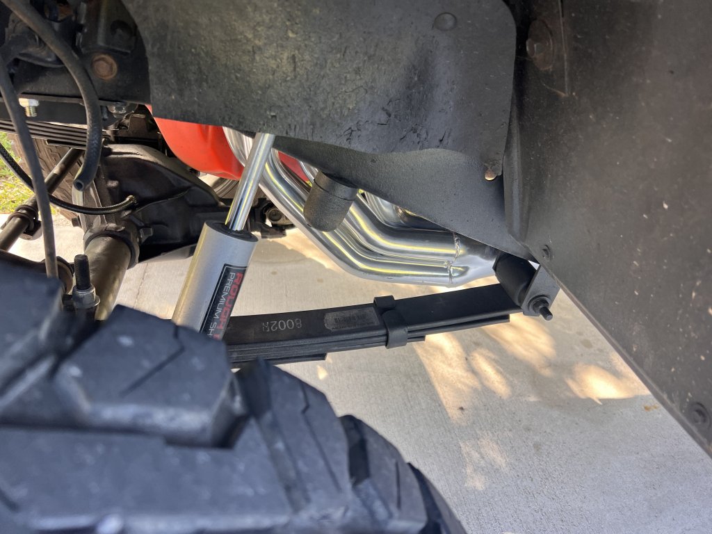

The only issue I see is that the underside of your truck is way too clean. It will not function properly if it's not covered with grease and dirt. Noob.
Came clean. Once I get the axles figured out I’m going to dirty her up. EXCEPT the headers they have to stay shiny
