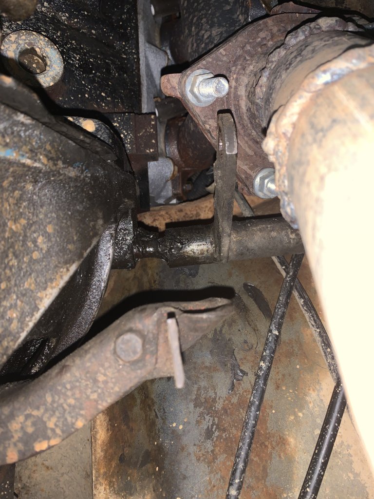

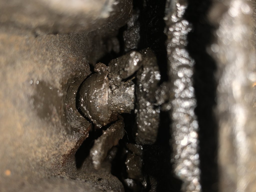

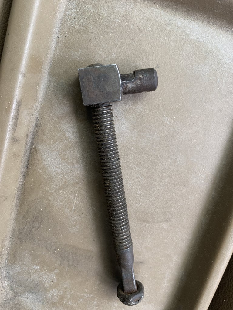

78 k10 with a 5.3l ls and sm465, sachs1050 flywheel stock 12” 1978 k10 clutch. My clutch pedal stays closer to the floor than I’d like plus if I try to shift gears quickly you can feel it grind for a split second before going into the next gear. My adjustment rod is maxed out at the end of its threads. I can yank the pedal the rest of the way up (2-3” travel) and you can audibly hear the throw out bearing rattle back and forth(crawled under and verified it was sliding back and forth and causing the rattle, also what caused my original concern) why does my pedal not return back to atleast the same height as the brake pedal? I also noticed my clutch fork moves in relation to the throw out bearing. I can twist the clutch fork and it changed the geometry between the adjusting rod and the fork. I know it needs the longer throw out bearing but that still doesn’t explain why the fork moves and my pedal has just never returned, I didn’t know it came up that high until I pulled up on it.
Edit: with the pedal all the way to the floor the truck doesn’t move, <1” or so off the floor the truck is moving.
