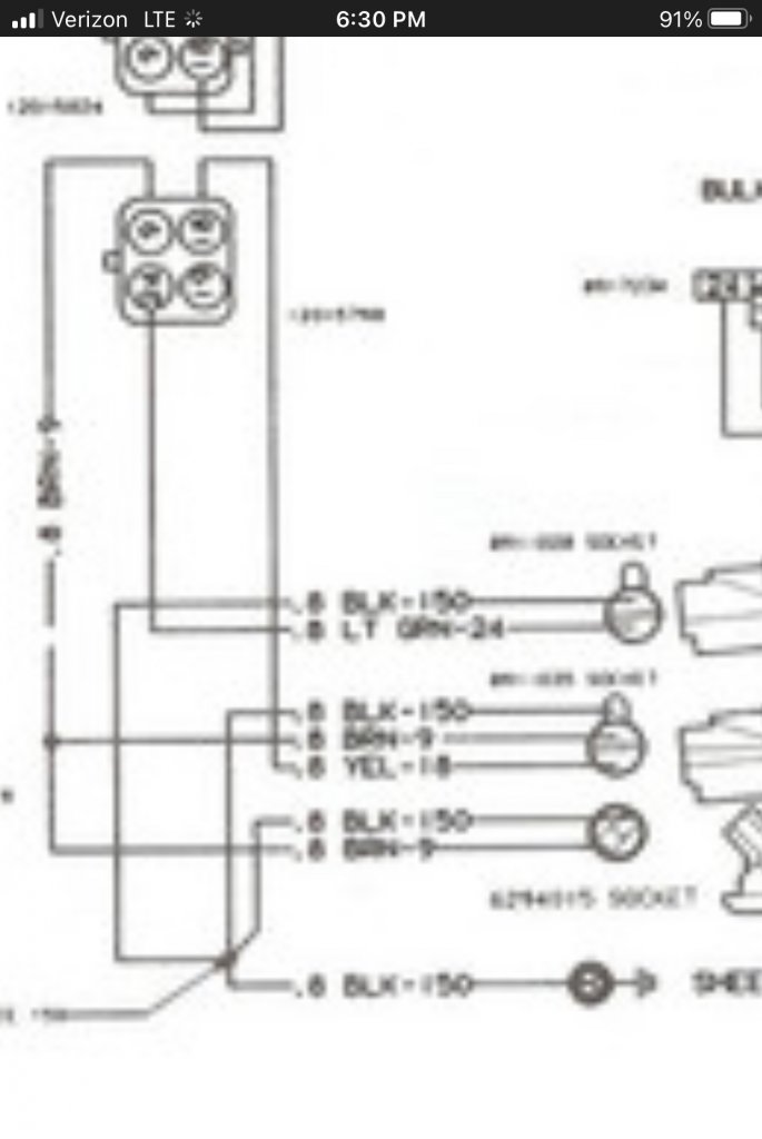

Can anyone tell me the location of the circuit 150 splice location?
And, is it the same as the ground bus bar near the parking brake?
Thanks!

If this is the splice you’re looking for, it will be in each taillight harness. Find the ground screw connector, follow it towards the front of the truck.
What are you working on? The main dash harness is grounded to a 5/16 bolt at the right lower corner behind the dash.

Oh, sorry.
I meant the one under the dash.
The more I look at this, the more circuit 150's I am finding.

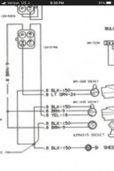

This one here.
Looks to be near the fuse block I guess?

The main dash ground is up behind the left corner of the dash. With the dash bezel out of the way it’s easy to see.
What are you trying to fix? If that main ground was bad, I don’t think anything would work. Definitely not the radio or dash lamps
