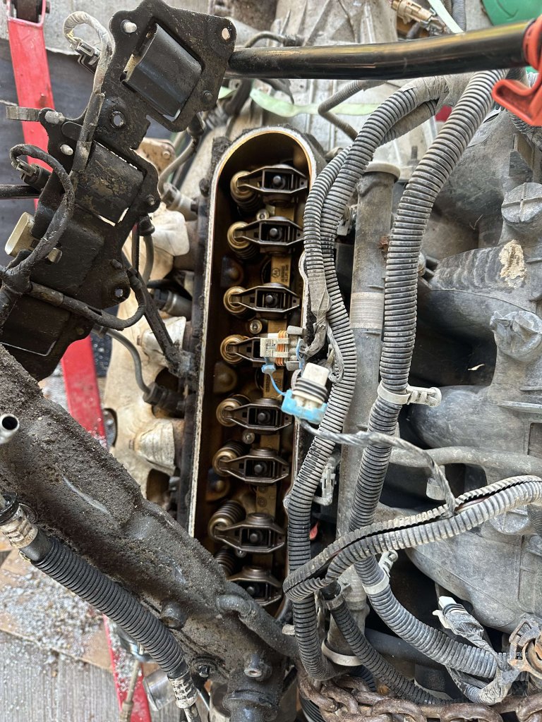

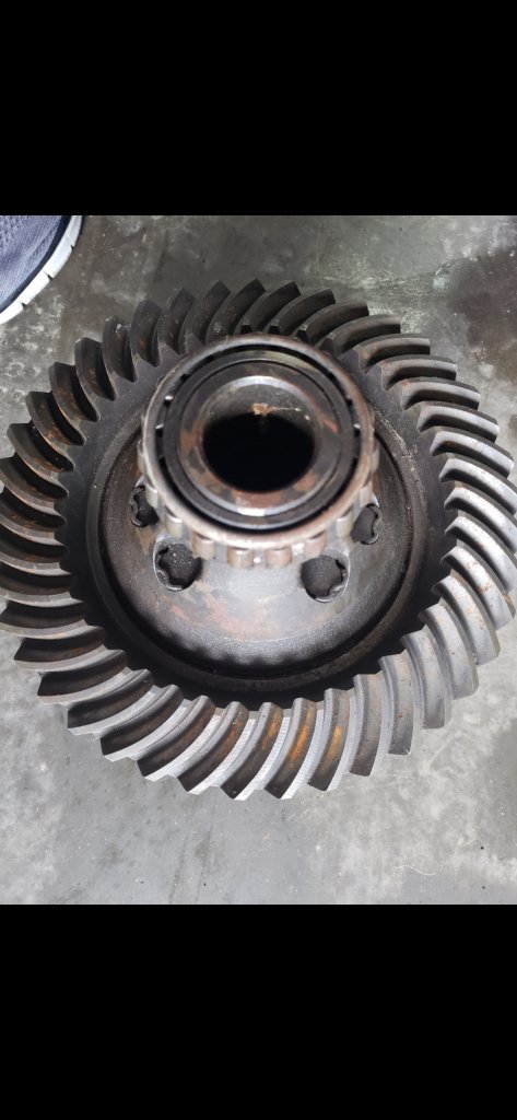

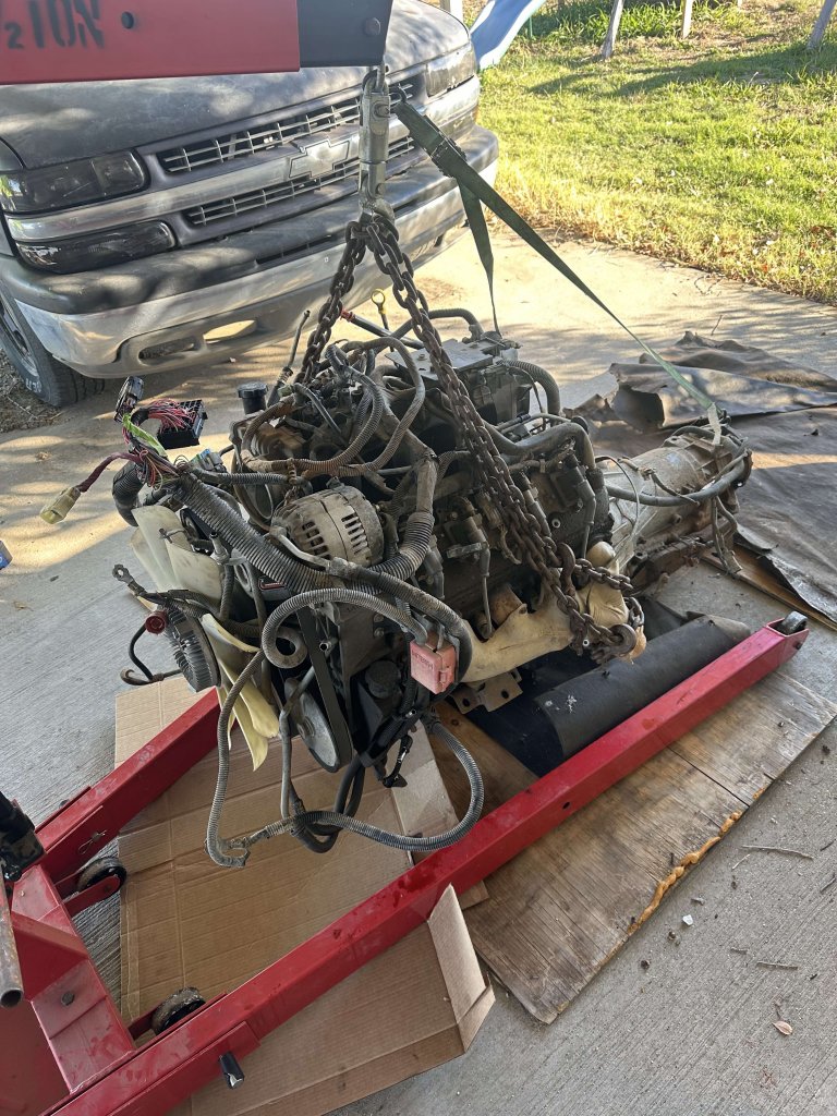

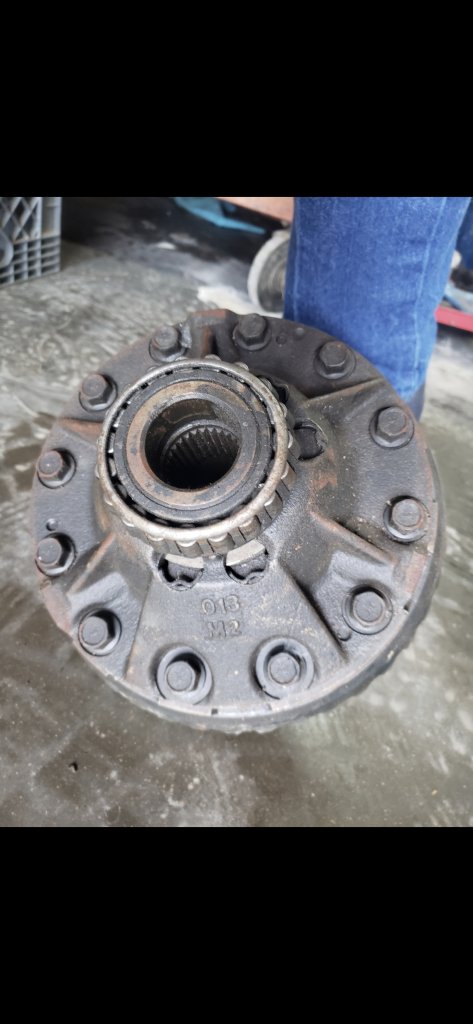

Replaced all A/C except lines and compressor. Hang meat and part hair now! Next is 6.0. '03 LQ4 "low miles". Kick'n around the tranny options. I do pull a boat, 21 CC and occasionally a 26ft camper. 4L80E seems logical.(Looking). In it is a TH400 rebuilt 8k miles back but I'm doing DBW swap so no TV kickdown. 4:10's in diff. right now but will stab a Eaton 10.5" Limited Slip 3:73 I pkd/u couple yrs.back for $25. Ofcourse complete diff. reseal and brgs. Learning alot and like most of us, on a budget to some degree. I wanna do the swap and learn but 35+ doing this and at 62 seems like a younger man's profit. I don't have and never really had to much money for looks as I did for function so that's where my money goes. It's a work truck but with a great headliner I slapped in. Tks ali_c20, Ricko1966, Gjonick and the rest of ya for chime'n in! I'll definitely ck back in. ✌️
