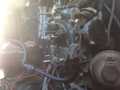

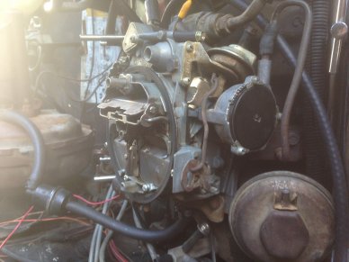

Now check that it opens all the way when warm. Takes several minutes.

This is where it was staying most all the time, even when cold!

And when it's warmed up to OT it's here!
