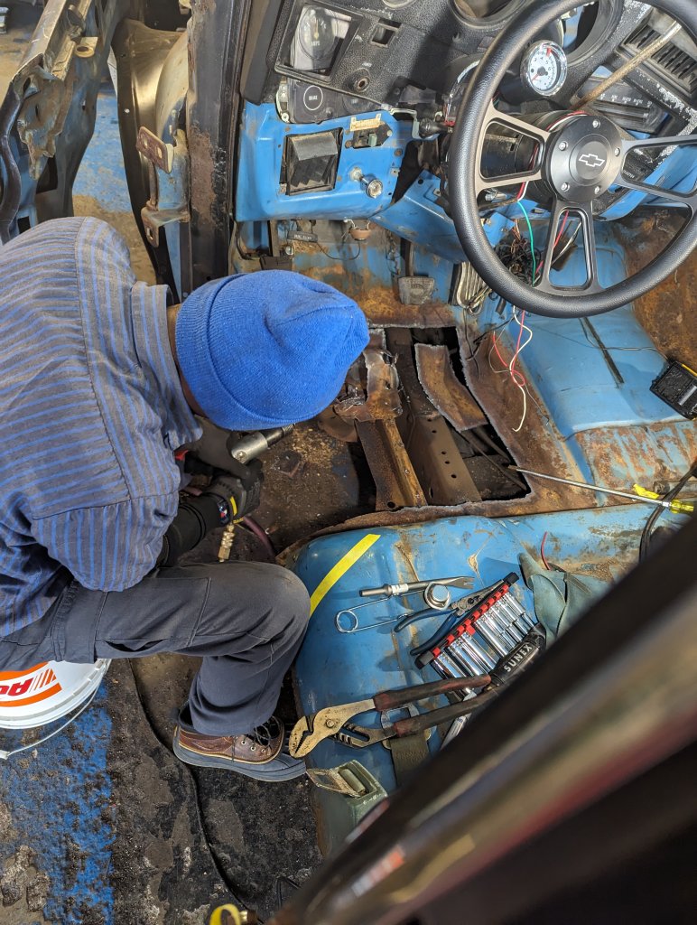

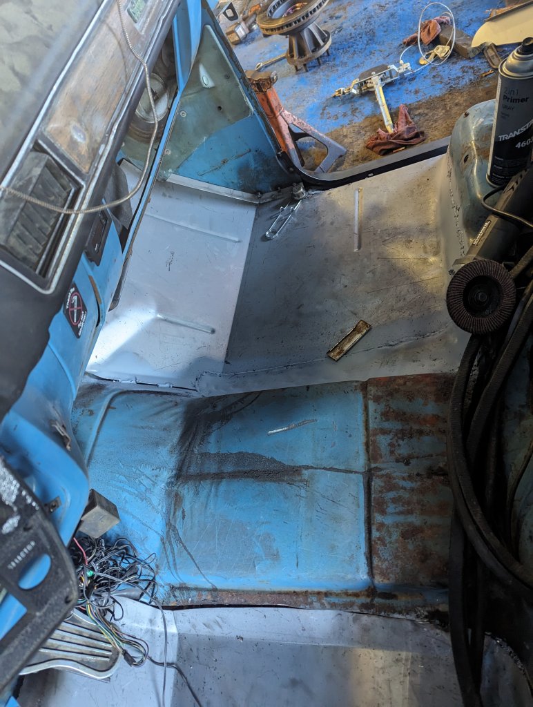

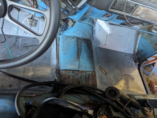

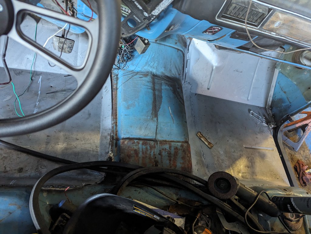

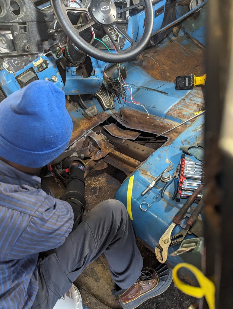

Will try to do that when I get a chance.currently we are on the cancer clearing stage on the floor boards. #rust.

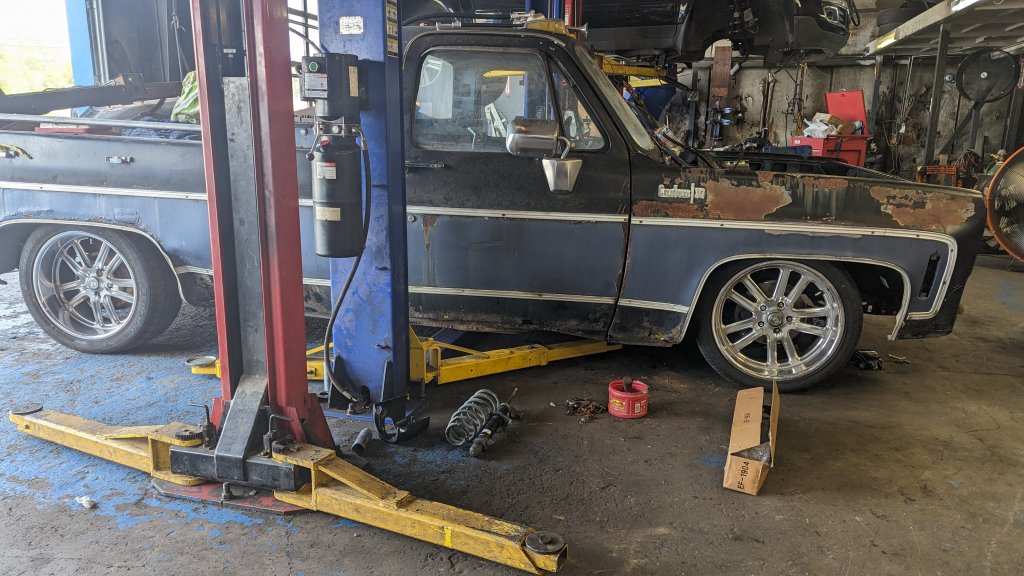

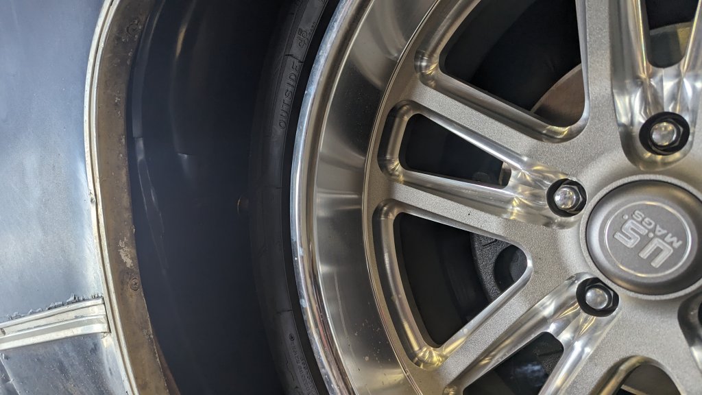

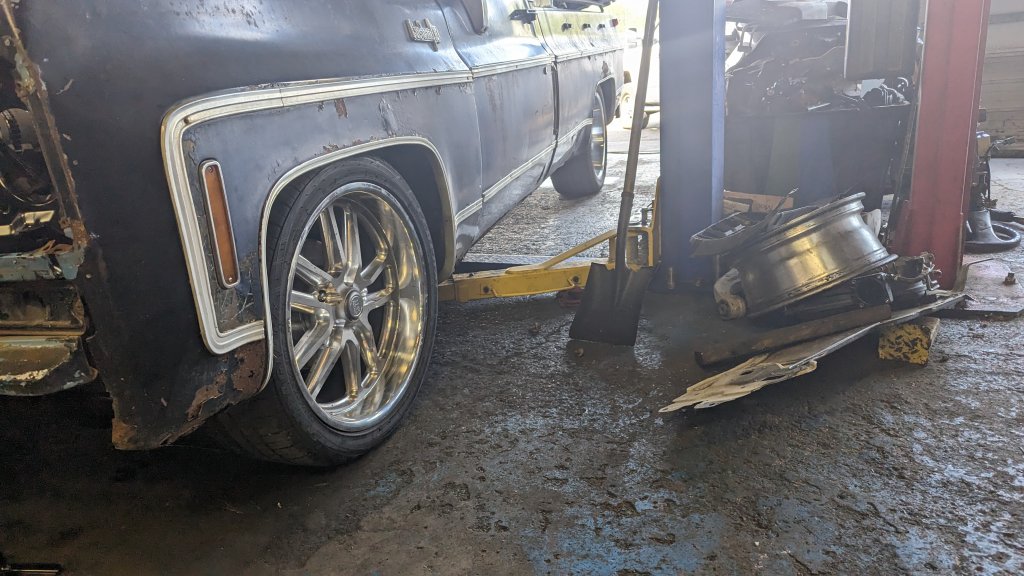

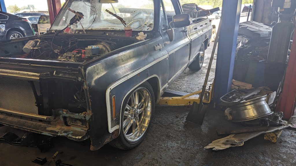

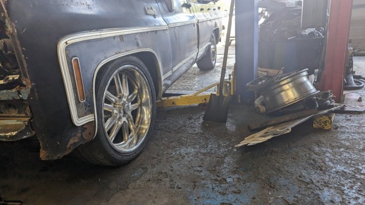

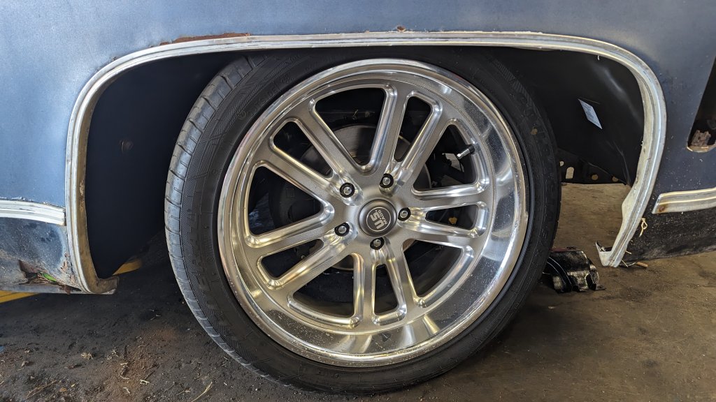

These are the best 2 pictures I could find to illustrate what I mean, you can see how the driver's fender is about even with the top of the tire/right at the tread. The passenger fender is down the sidewall a good bit. My truck is ~3/8" lower on the passenger side front without me in the truck and you can tell it in person. Much harder to see in pictures. In the rear, I'm within 1/8" of each other. So to fix my truck, I need to either trim the driver's side spring a touch more to bring it down even with the passenger side, or I need to add those coil risers to the passenger side to bring it up higher to be the same as the driver's side.
Since you're rubbing, you'll need to either raise your lower corner or install SloshTubz and trim the high corner to bring it down level. I rubbed real bad on my original inner fenders but wanted the down in the weeds look, so I installed SloshTubz to get the clearance I needed.
Some pics. Hope this helps..

So that's exactly the same as my truck, just yours is even lower on the pass side. So you definitely either need different front springs, a coil spacer or those coil spring risers I mentioned to raise the pass side up. Or trim some off the driver's side coil to bring that side down further, whichever one. But if you don't want to deal with rubbing, the pass side will need to come up.
Yeah and that's what I'm going for. Drivwrs side was cool and no rub. Passenger side was hitting the tub. A definite no go. We're gonna reseat them and if that doesn't work try the spacers on the passenger side. Thanks fellas for everything

And it's worth noting, be conservative with a coil spacer. A 1/4" spacer will net ~1/2" at the wheel.
Will do. Any product links will also help if anyone has any. I don't wanna grab the wrong thing. Keep in mind. This is a 2 inch drop spring and 3.5 inch drop spindle. It's in the woodsssss

Have you checked your cab mounts and bushings? Saying this as the pic of the side shows the cab low.
