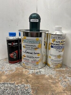

i found this paint kit on ebay. it used to be the color of my first truck. would this work?

It would work for sure. Acrylic won't hold up to the sun near as long as urethane I believe though.
what about Acrylic Urethane? Summit sells it.
7,713
13,730
Auburn, Washington
Idk, maybe I'm all backwards on this. I've always viewed Acrylic enamel as "old" technology and urethane as newer, more durable, etc.
I might be just passing bad info as I don't know the actual differences or what Acrylic Urethane is vs the other terminology I was using. But here's what I copied from the interwebs that seems to support what I was saying.
