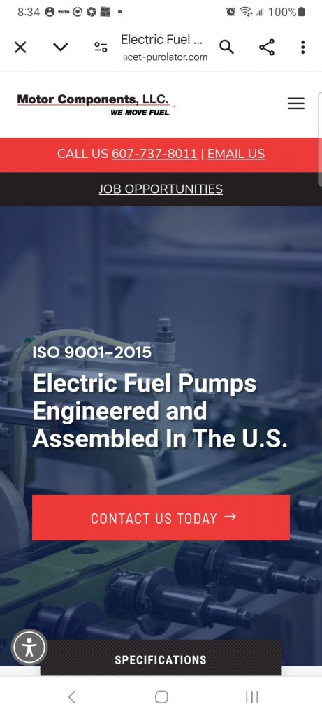

DO NOT put an eclectic fuel pump on a carbed engine. The machinal stock fuel pump will run everything short of dual quads.

I agree,I prefer a mechanical pump and have always told everyone that's what to run,and they will run 2x4s or 3x2s,But try buying one today,that has correct fuel pressure and is assembled correctly,it is more likely you will get a bad one than a good one..
I had luck with Carter pumps, all working without flaw. Fuel pressure ratings and real pressure is not matching most of the time. That's why I run fuel pressure regulators.
9,948
19,087
So your expierience also is that pressure isn't correct,without the use of an external presdure regulator

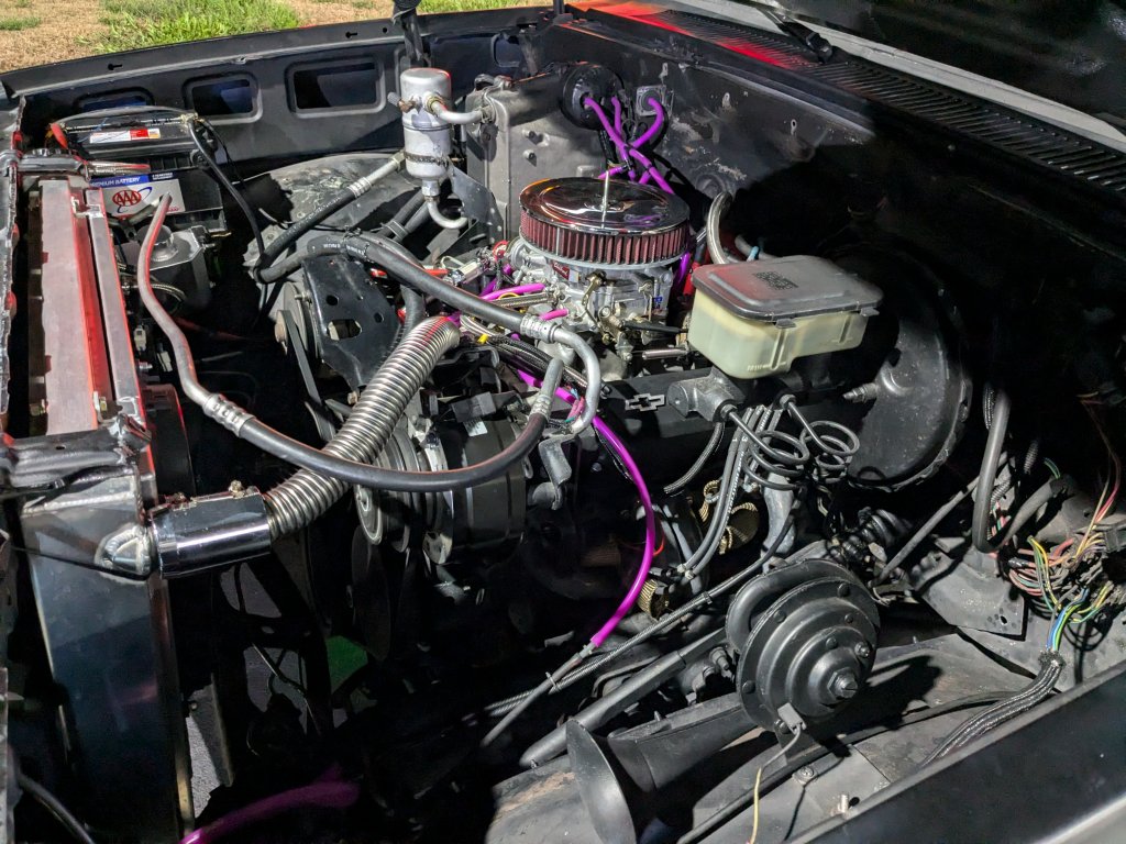

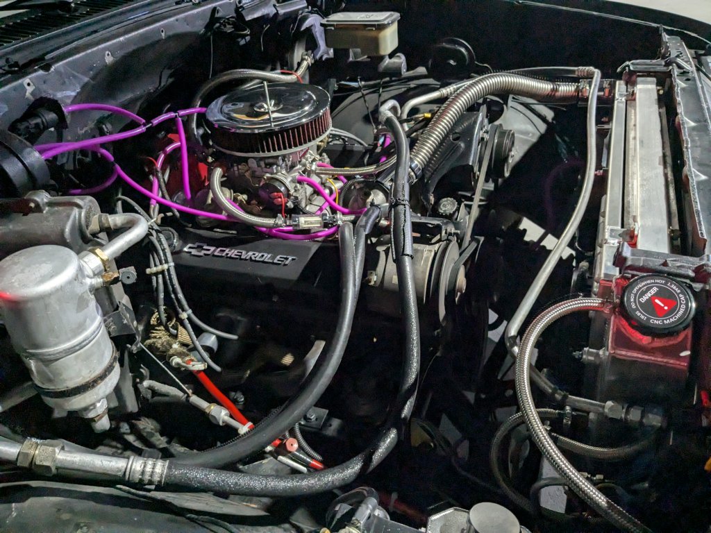

Finally got my electric choke working fine and understanding the functionality of it... meaning, in the morning I hit the gas pedal one time before starting it resets the cam with the choke and I get my fast idle speed until the truck is warmed up......the way it's supposed to work.
However what I don't like is once I'm driving the truck, cut it off, let it sit for a while then truck doesn't start right up.... I have to pump the gas a few times to get it to start.... I don't understand why it's that. Do y'all think it's because it's a carbureted system and now fuel injection?

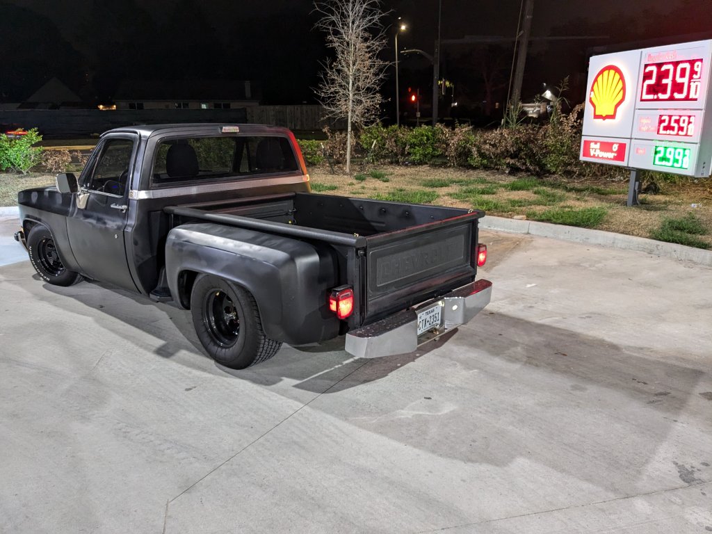

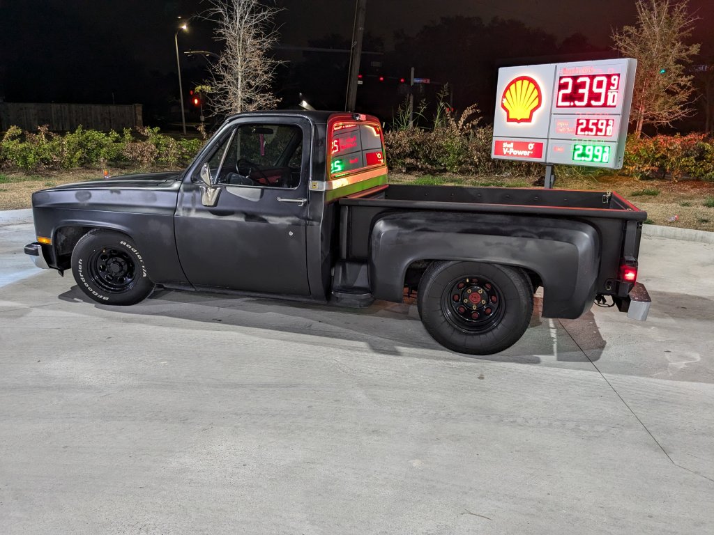

I don't know if I ever showed you guys a pic of my truck but here it is
