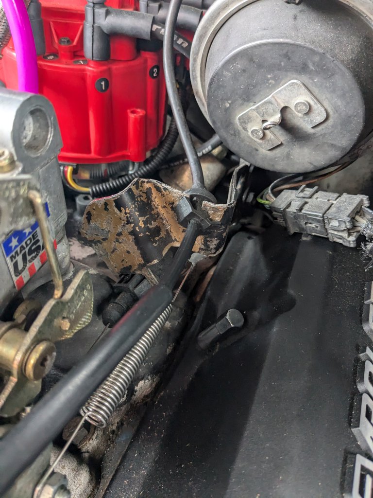

What is this bracket called that the acceleration cable runs through
