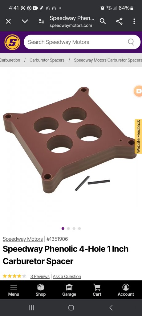

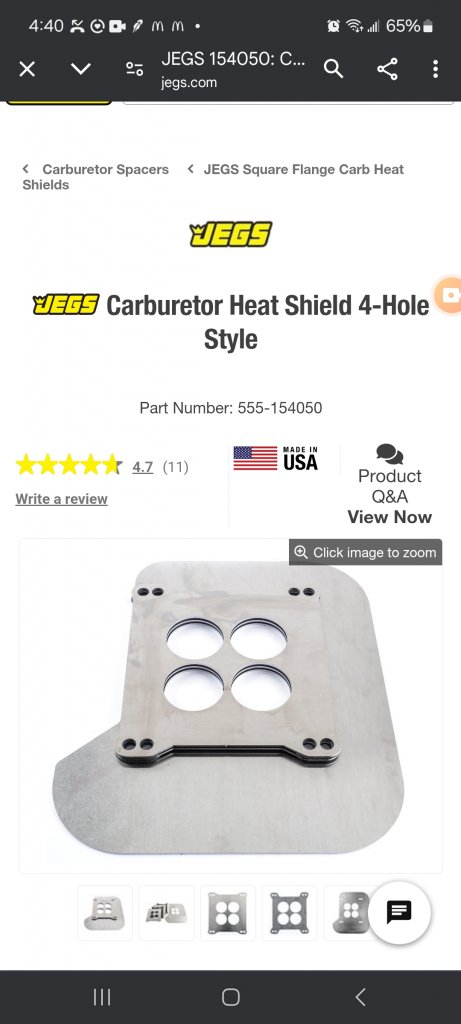

Just a random thought but has anyone considered a drain-back issue?
9,948
19,087
Not a possibility on an Edelbrock 1406,due to location of fuel inlet and needle and seat. 2 like these should stop your fuel boiling. If that's the problem
wdym not possible?
