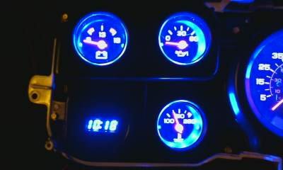

i started building these for sale after i did my two trucks 85 strep side and 87 4x4.look pretty cool at night.Just a hobbie,do about 2 a week.if enterested contack [email protected]
This site is awsome.enjoy hanging out with chevy truck peps and looking at thier trucks.cool...evan

THose are awesome! god id love some, looks like i have emailing to do

How much are they?
Mines about shot
Circuit board is rusted and cracked and hardly lights up

I wouldn't hold my breath waiting for an answer - he hasn't posted since last October. Also, his domain name - customchevytruckgauges.com - expired on March 9th.

Jerry brings up a good point. If you really took the time and was patient about it, you could probably do it yourself and end up with the desired affect you're seeing in his pics. He is adding a digital clock which is cool, but for the most part, I believe he's pretty much just testing the gauges to make sure they work, cleaning the cluster, painting the interior of the housing, and installing LED dash lights. Do keep in mind, when you use the LED lights, you lose the function to dim your dash lights. They're either on, or they are off.

If it's just the blue color that you are looking for - and still want to retain the dimming capablity - try these.
They are a standard T-3 1/4 incandescent lamp (same as stock) and rated at 5W. A stock 168, by comparison is 4.9 W. However, due to the blue tint, they will probably not appear to be quite as bright.
Anyway, it's an option to consider. There are 5 backlight lamps in your cluster. So, 3 packs of these at $9 per = $27.
MAX performance bulbs
$8.95 Pair
BLUE 194 12V 5W
* Lamp no: 194-B
* Volts: 12V
* Watts: 5W
* Bulb: T-3 1/4
* Base: Wedge W2.1x9.5d
* Desc: Miniature Wedge Blue coated
http://www.autotoys.com/x/product.php?productid=16399&cat=265&page=1#tabs
