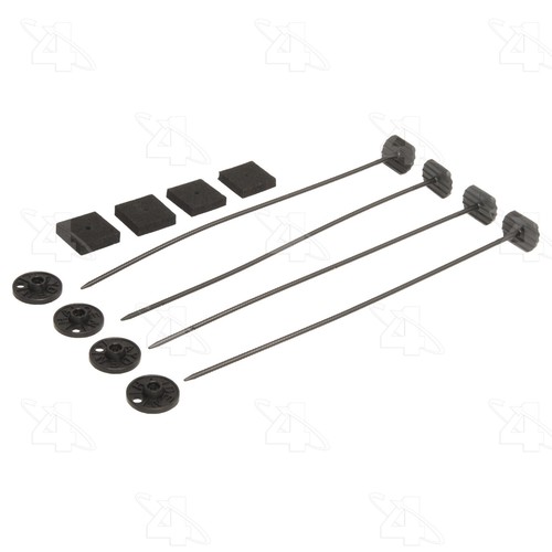

Yep that "little radiator" is most likely a transmission fluid cooler. It should be mounted to the radiator - usually with padded zip ties , not simply laying there. You would HATE to poke a hole in that deal - they aren't strong at all it's made from aluminum. You also cannot allow it to bounce around and poke a hole in your radiator. I bet you can buy a new "Transmission cooler mounting kit".
You're gonna want to look into that without question because you're on borrowed time right now. Hope this helps!

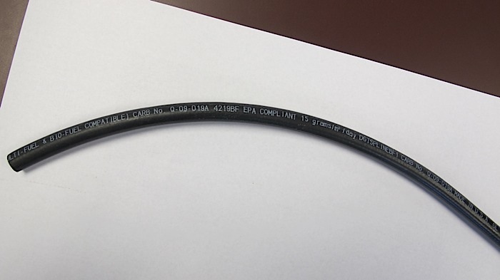

When you buy fuel line, consider upgrading to EFI rated line, because it holds up much better to modern fuel with ethanol.
Line that meets SAE J30R7 standard is a more flexible general purpose fuel and emissions hose, while SAE J30R9 is for high pressure fuel injection systems. J30R7 is expensive by the foot at the parts store, but you can buy it in various lengths from Amazon or on eBay. It will hold up much better and not degrade inside or crack outside.
