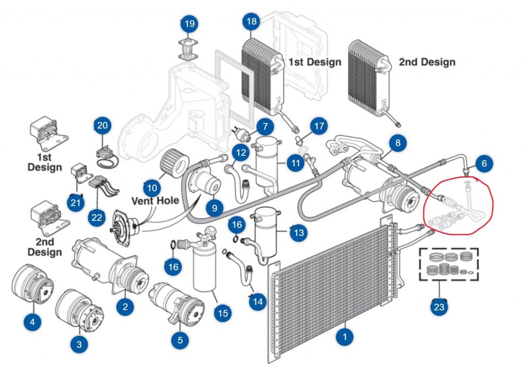

2. Come next summer, I will want to get the A/C working, and I ordered the whole OEM style shooting match from LMC to have on hand when the time comes. LMC did not offer all of the lines, however, as you can see in the attached diagram circled in red. Can you guys tell me what that part is and where I might locate it?

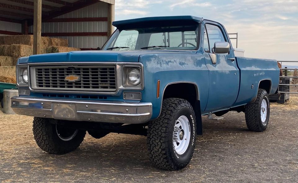

Wow! Ida kept the 73/74 grille style. Love those.
Someone must’ve put an older core support n stuff in it. As those grilles are not supposed to fit in 75 (I think ) and up trucks because they set deeper than the newer models.
New one bolt right in?
Regarding gears, even if it was special ordered I’m fairly certain the axle is identical. 14bolt full floater.
That said, 4.56 is almost un driveable unless you never get on I 82 and only take back roads at 55mph.
I have 4.10s with new 35s and that is prohibitive for freeway driving imo.
3000rpms at 70mph roughly is what I get, just not conducive for driving the open road. I’d strongly consider you think about 3.73s tops and possibly a little higher even if it’s going to be a go everywhere daily driver.
