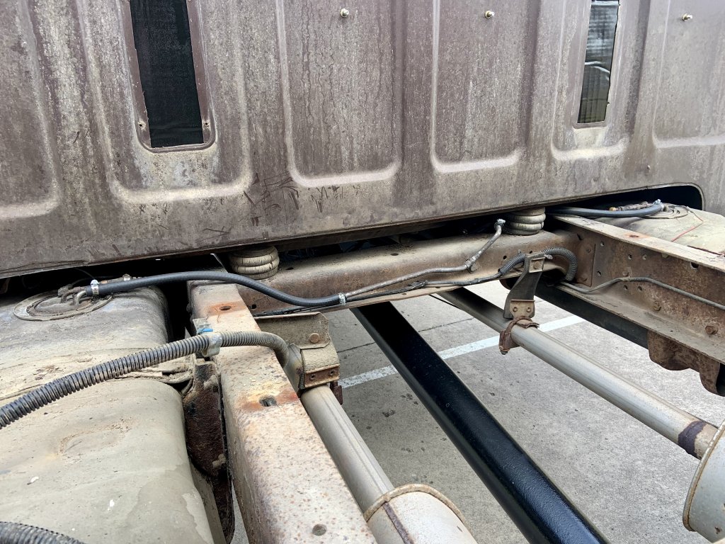

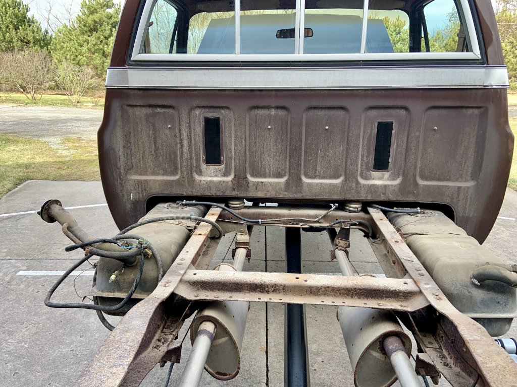

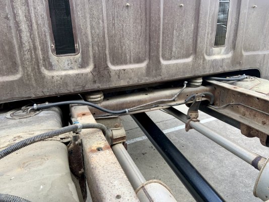

I am converting a C10 frame to K10 and looking at pics of my old frame that I sold long before I got this frame to convert it looks like the rear cab mount is below the frame rail a smidge where the C10 mount is even with it. It looks like about 1.5-2" difference. I may have to custom cut a rear mount as currently using C10 mounts it sets the cab on a 4L60 transmission.
ETA yes cab has a high hump as its an 86/87 stripped K10 cab.
Actual K10 frame
C10 conversion frame
Actual K10 frame
