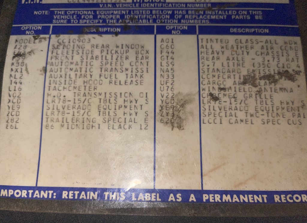

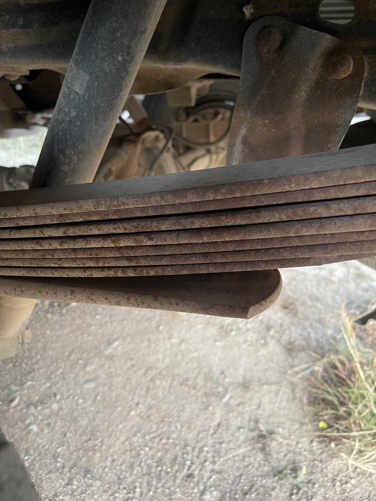

I agree, 11K GVWR is a bit much for a 1/2 ton (lol). Petty sure it won't tote that much weight. I think you're right about the emissions requirements. I got home and looked and I was wrong on the spring pack. Instead of 10 like I previously posted, it only has 8. It does have 5 lug axles. I took a pic of the SPID in the glovebox. Thanks for all the great info.

That's a pretty cool optioned rig!
I think those emblems are original. The Trailering Special option is clearly on your SPID and the emblems state 11k gross combined weight, not gross vehicle weight. Combined weight would be the weight of the truck and trailer too.
