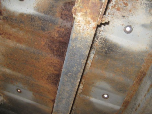

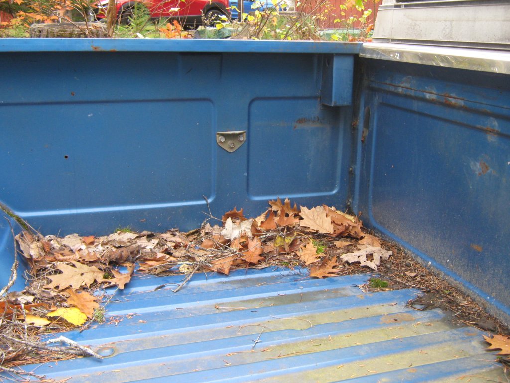

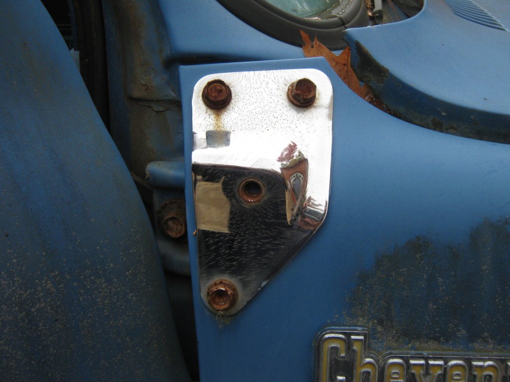

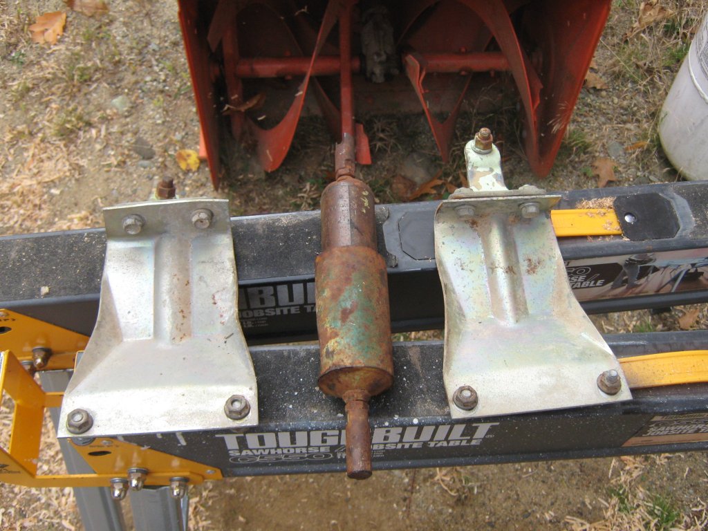

My '74 is a camper special. It has brackets on the front fenders for a slide on & over the cab camper, it came with towing mirrors (since removed), dampening absorbers from inside the cab to the bed and four camper mounting brackets at both ends of the bed coming off the frame. I'm not sure if an '82 would have anything similar.
31,892
32,686
All those were part of the most elaborate camper special package. Do you have pictures of the cab-bed shock absorber setup?

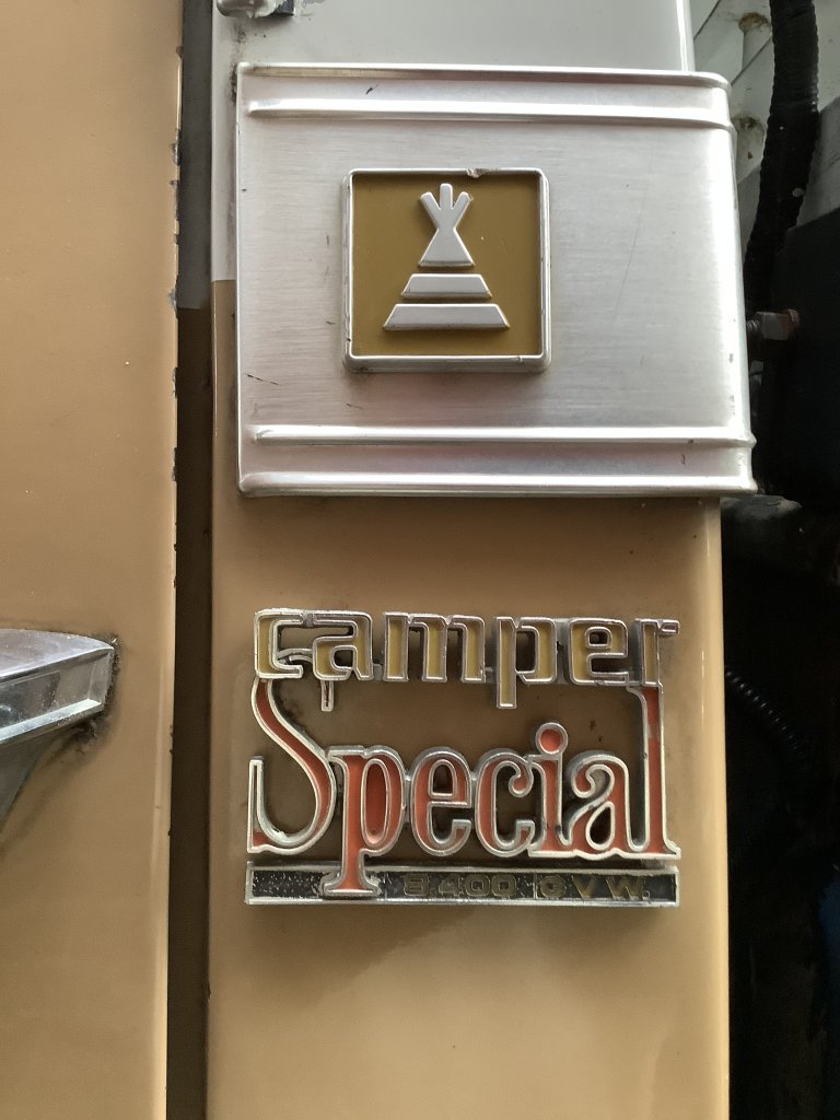

Not sure about your year of truck, but for my ‘75, the Camper Specials have a Teepee emblem in the trim on the side of the cab.
I have the deluxe package with Elimi-Pitch and it's impossible to miss.
- Brackets bolted to the back of the cab extend through holes in the bed front, where they could bolt to the camper and tie it to the cab.
- brackets mounted on the top of the front fender, where you would bolt a shock absorber rod that went up to the camper overhang to stabilize it. My brackets got lost by the body shop when I had the truck painted many years ago.
Camper Specials also have a splice in the wiring running to the back of the truck, so you can connect the camper lights. My wiring was cut under the truck near the bed front, so I extended it and put lights in my headache rack.

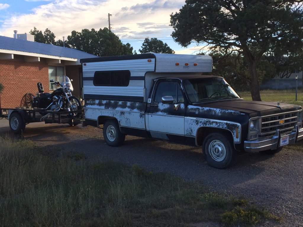

HI Keith. Do you know where I could get the CGWR for my 83 C20? I do not have a SPID label. It is a long bed regular cab 2WD 4:10 rear axle with SM465 manual 4 Speed with 454 engine. It is a camper special but does not have any of the extra brackets described above. The previous owner used it with a slide in truck camper. Thanks.

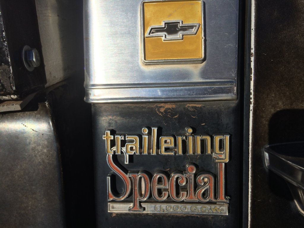

Been a member for a long time but have never posted anything. This is on my 1979. It’s a C10 Silverado that carries the “big 10” badges on the bed. It also has 10 rear leaf springs. So I think it was considered a “heavy half”? I’m the second owner and I knew the family that bought it new. I’ve kept it all original so these are the badges that came on it. Not sure if it helps you out any?
