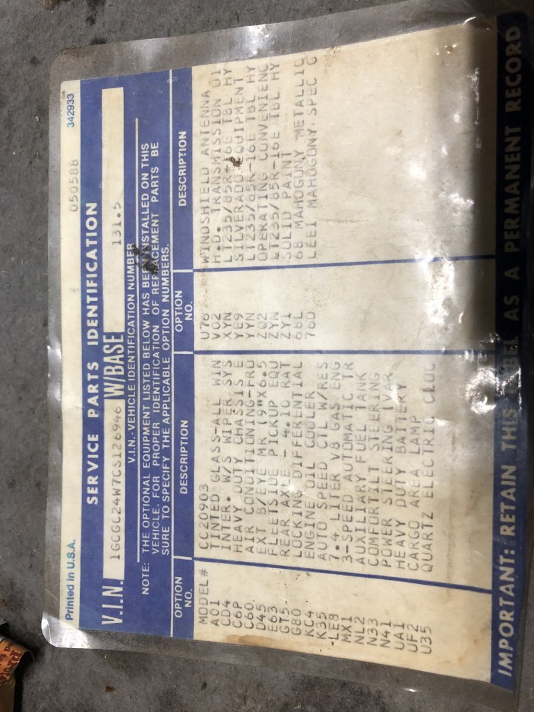

My 82 C20 has the C6P option which says heavy duty chassis.
