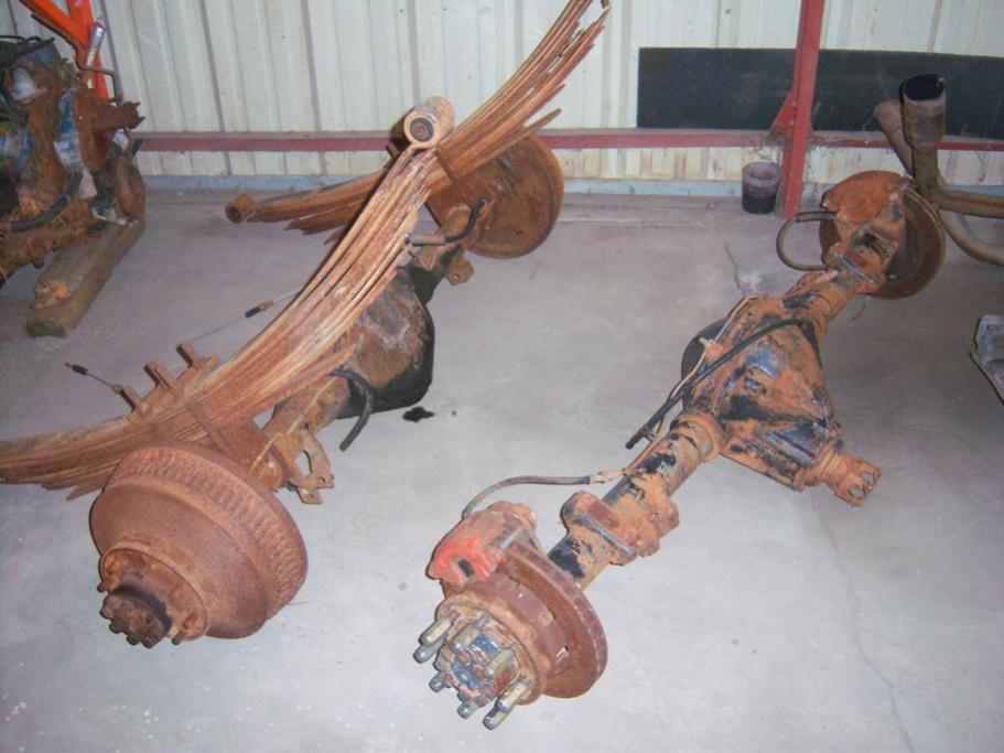

My DD 84 C20 have 14b FF 3.21 ratio, my Burb has 14b FF 3.73, and in the shop on the ground, I have a 14b FF 4.10, and the CUCV 14b FF 4.56 with Detroit Locker and Disk brake conversion. The twin 84 & 85 C20's both have 14b Semi Float 8 lug 4.10 peg leggers, which that project gets one of the loose 14b FF that are in the shop. Just depends which Front Axle 8 lugger I find to match which rear end, then the one left over is for the 84/85 C20 project. The 14b Semi Float will be the trailer axle. I've got to many damn good parts. This is why I am so frustrated and overwhelmed with which projects to work on.
attachment.php
