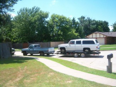

This trailer only had brakes on 1 axle. It did fine for the 50 mile tow at 65mph, but the 3/4 ton Burb didn't have a motor or trans in it either and I could tell it would have made a difference to have the 2nd set of brakes if I needed a fast stop. Biggest part is knowing how to drive with heavier trailer. Allowing more space, don't be tailgating, and know how to use your brake controller manual braking feature if it starts to get squirlly back there. I've seen several people lose it with trailers. Once they start swaying, it's a bit touchy to get it back under control and the worse thing you can do is hit your towing vehicle brakes and put you right into a jackknife. Even brakes on 1 axle and a brake controller can get you out of the mess real quick no matter what the weight is, so at least have 1 axle with brakes if towing a vehicle.

:drool: that white burb makes me happy in the pants
