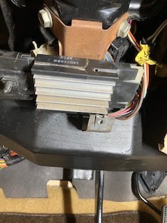

Does anyone know where the bus bar ground for the door panel switches is located? I was hoping that it was behind the drivers side kick panel but it wasn't. While looking, I ran across a device attached to the bottom of the steering column. What is it?

should be under the dash above the kick panel above the e brake. you will have to get upside down to look up under there with a light. prob has 6 prongs, mounted to metal. prob only 2-3 actual grounds attached.
the photo is the wiper delay module
