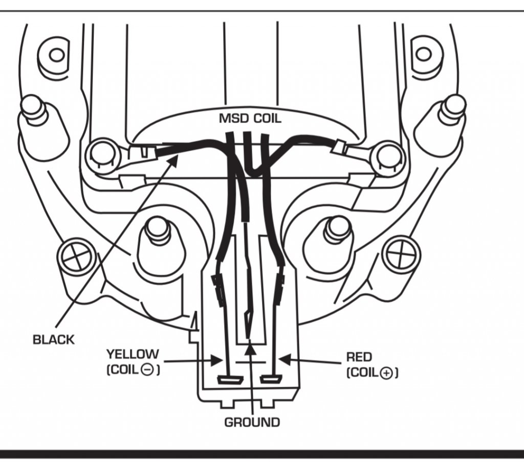

Your HEI coil should have 2 grounds,as pictured. The distributor body grounds through the distributor clamp through the block and you should have the engine block grounded either directly to the battery or frame. If you only have the 1 ground under the cap they burn up in short order. Make sure your distributor hold down is tight.what gap are you running on your plugs?

Thank you for the diagram I do not have that second ground strap it never had it to begin with even when it had the original 305 in it, it always had the one that connects to the coil that you screw down when you put the coil on , I will be sure to add that second one that goes to the ignition module wires. Also I have them gapped at .040. It’s a 355 with flattop pistons and 58cc aluminum heads
