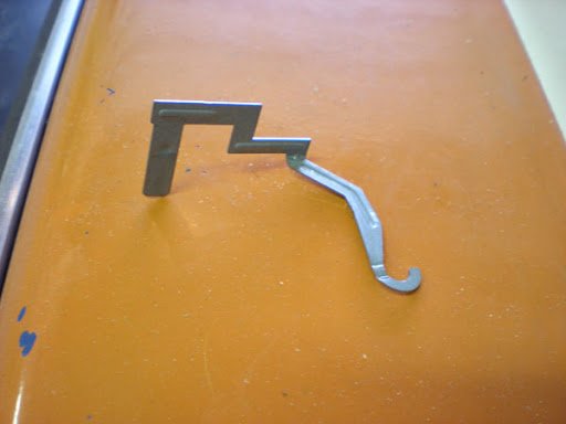

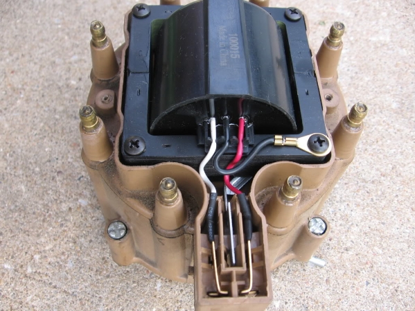

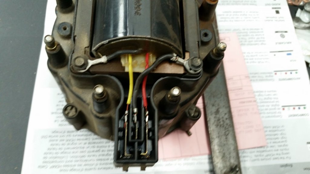

I accidentally left this ground strap off once on a Firebird years ago and got the same coil burning problem, didn't take long. I'll try to attach pics. One end of this ground strap goes down and becomes one of the three tabs that the wire connector plugs into. As I remember this strap goes Under the coil, (you can barely see the strap on pic at far right). Pic in the center shows a wire instead of the ground strap, I personally haven't seen one like this but looks like two designs to achieve the same thing.

Like a few other guys have commented, check your engine earths. Had a similar issue on a 65 Nova I had. Swapped engine plates to poly bushes and after 50 or so miles car started to back fire then cut out and wouldn’t start again. Ran a brand new earth strap across front of engine attached to both heads and block then to chassis and issue sorted. Must of gone through about 4 coils beforehand though!
