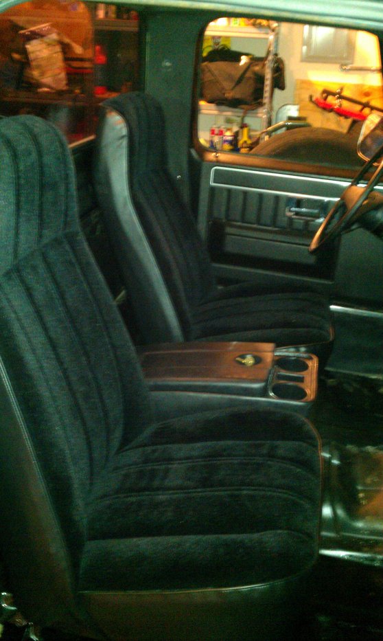

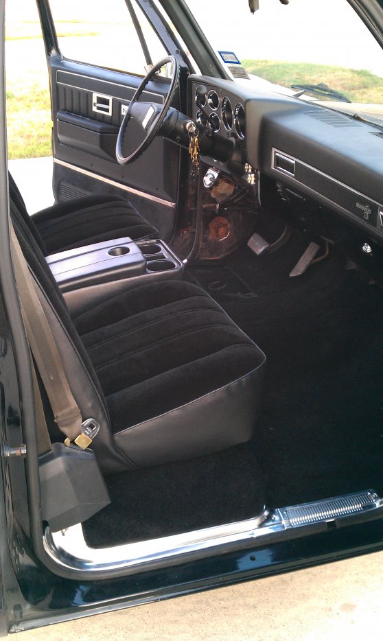

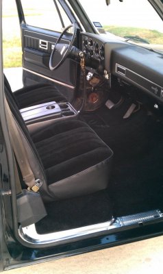

If you want hibacks all you need to do is get 77 and up blazer seats. You can cover them as you wish and they will bolt right up. Mine are 82 regular cab buckets but they are the same as blazer buckets.

The seat is the same. The brackets are different. He can use the blazer seat with the truck brackets.
