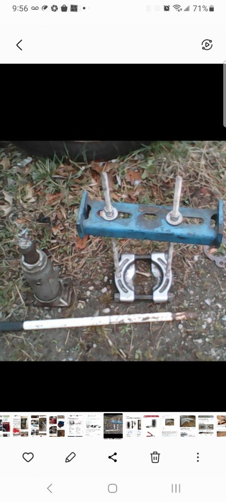

What I use for carrier bearings,and pinion bearings. I may use a different jack,but this has worked fine for me.
