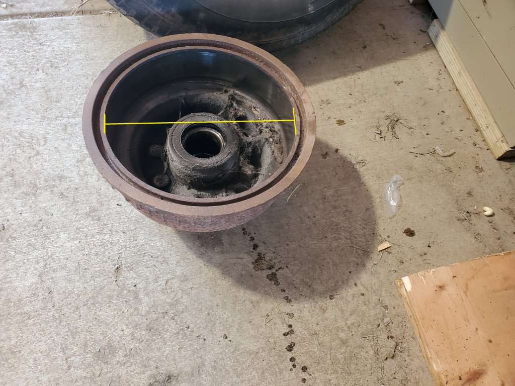

The inner diameter on the drum. My 1979 C20 has a 14 bolt FF with 11" rear and JB6 up front.
