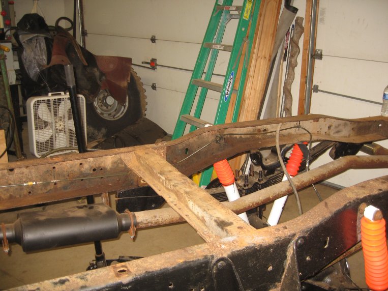

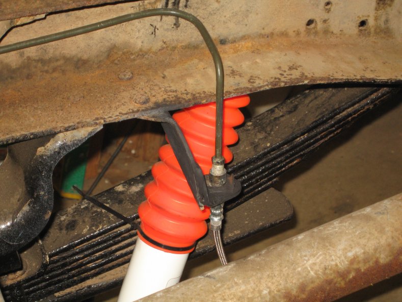

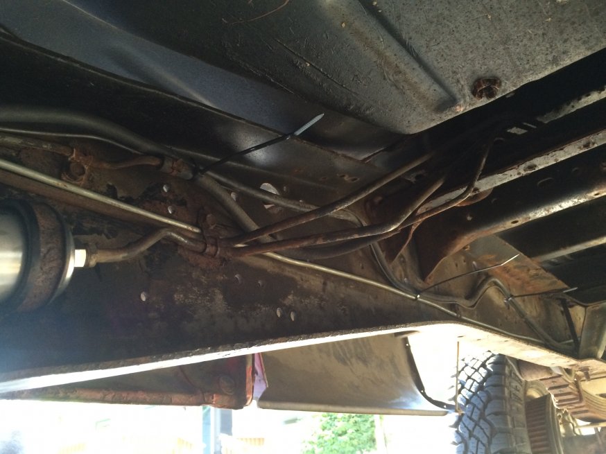

Here is a pic of the inside frame rail on my 1979 longbed. I replaced the rear brake line all the way from the prop valve clear to the stainless flex line.
At the back of the cab there is 2 clips, One for brake line and one for fuel line. Also look at the curve in the frame right behind the front tire. The brake line and fuel lines are stacked up. IIRC there are two clips pretty close together right in there. Good luck and I hope this helps.

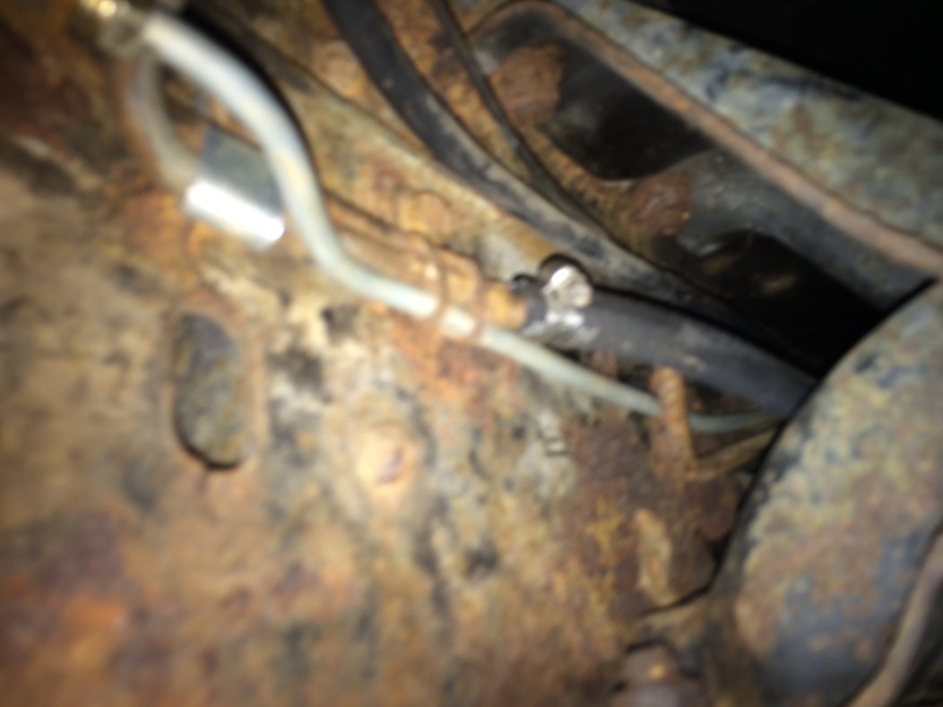

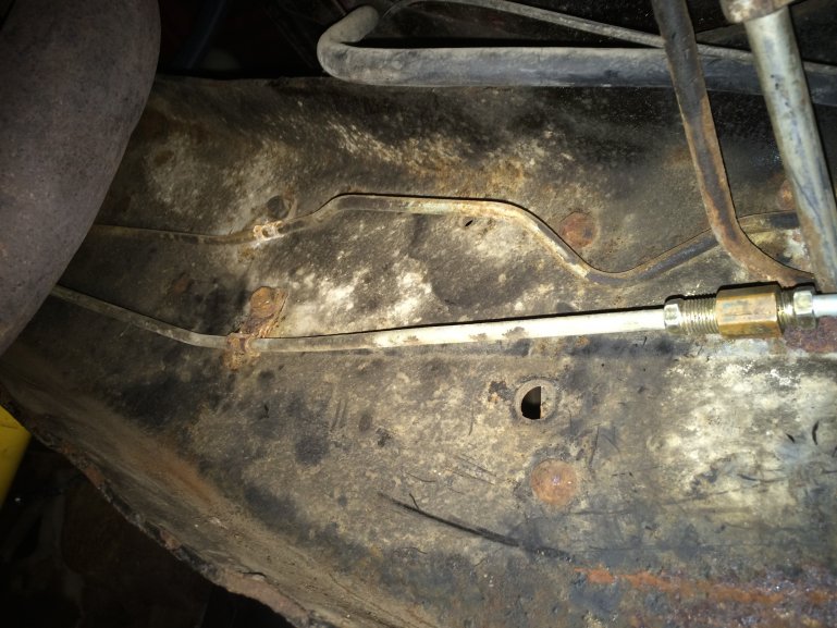

Here you go

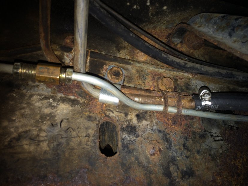

Take 2

Dont mind my fuel line mess. You will also see my cable for the lift gate.

Georgeb you are the MAN. Thank you so much I really appericate it.
Cheers
Adam

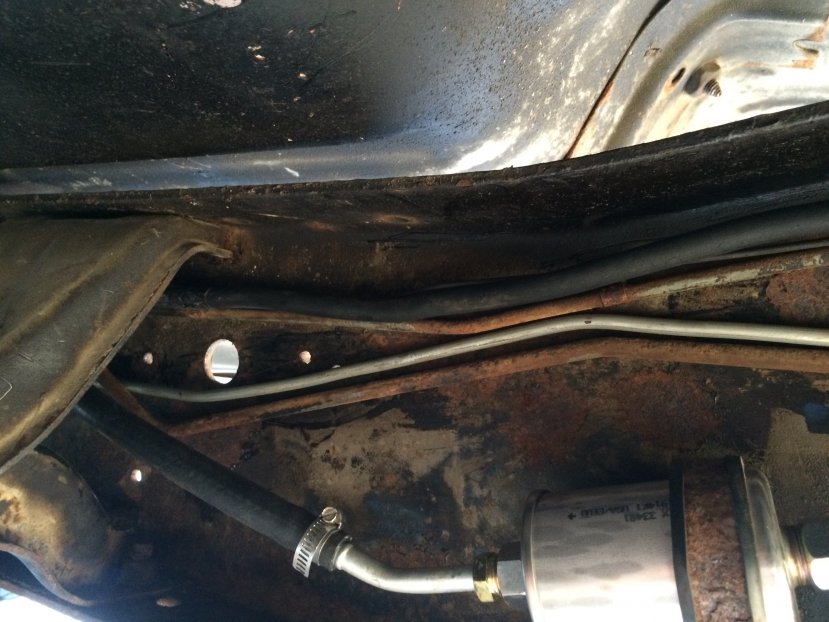

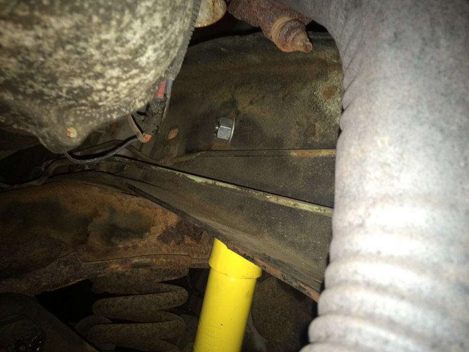

Sorry anout the quality its dark out now.

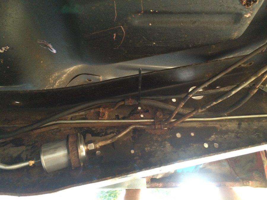

Pic two

Pic three

Pic four
