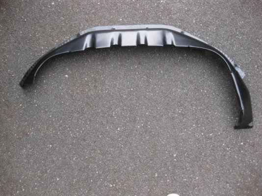

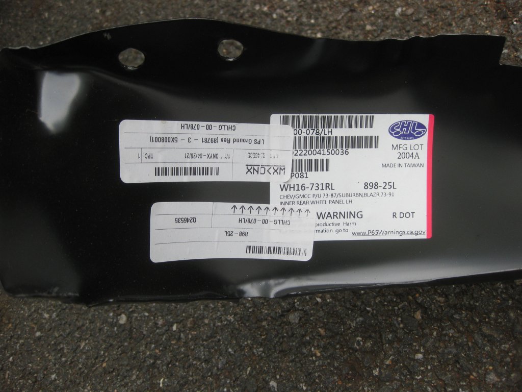

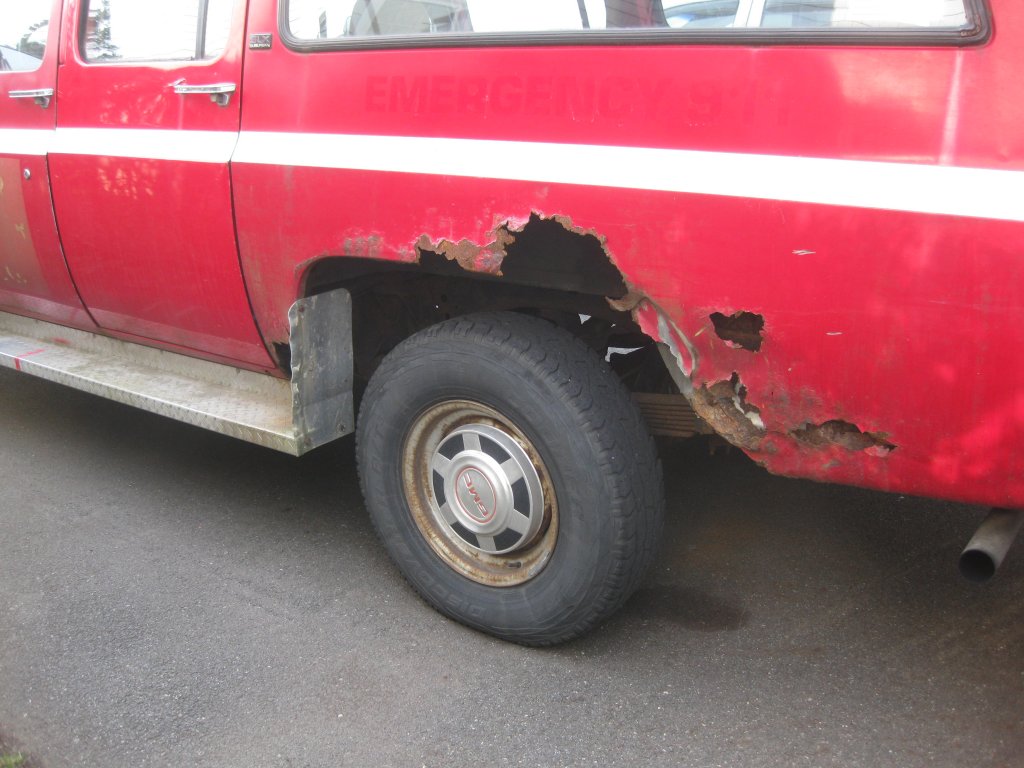

I have the part 50076L it is available from various vendors. All of the body parts I have used are made in Taiwan. Shop around for the best price. I found that prices can vary significantly. One vendor for body and other parts is LMC. They have a catalog specifically for the squarebody. Their website is LMCtruck.com.

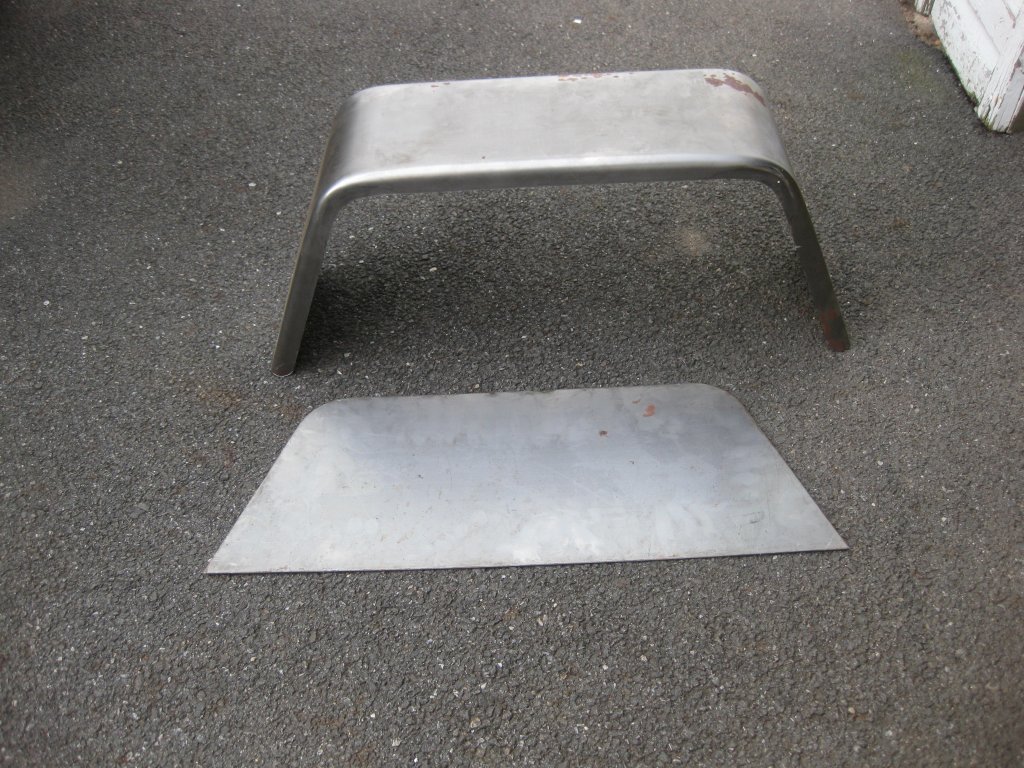

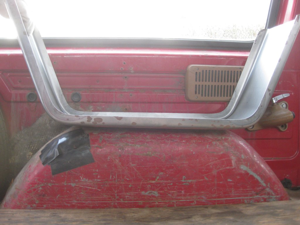

I bought trailer fenders to use in replacing the inside wheel tub. I will have to cut and fit the fender to replace the tub. These are two companies that sell the fenders I bought.
I have attached photos of the fenders and outer wheel house.

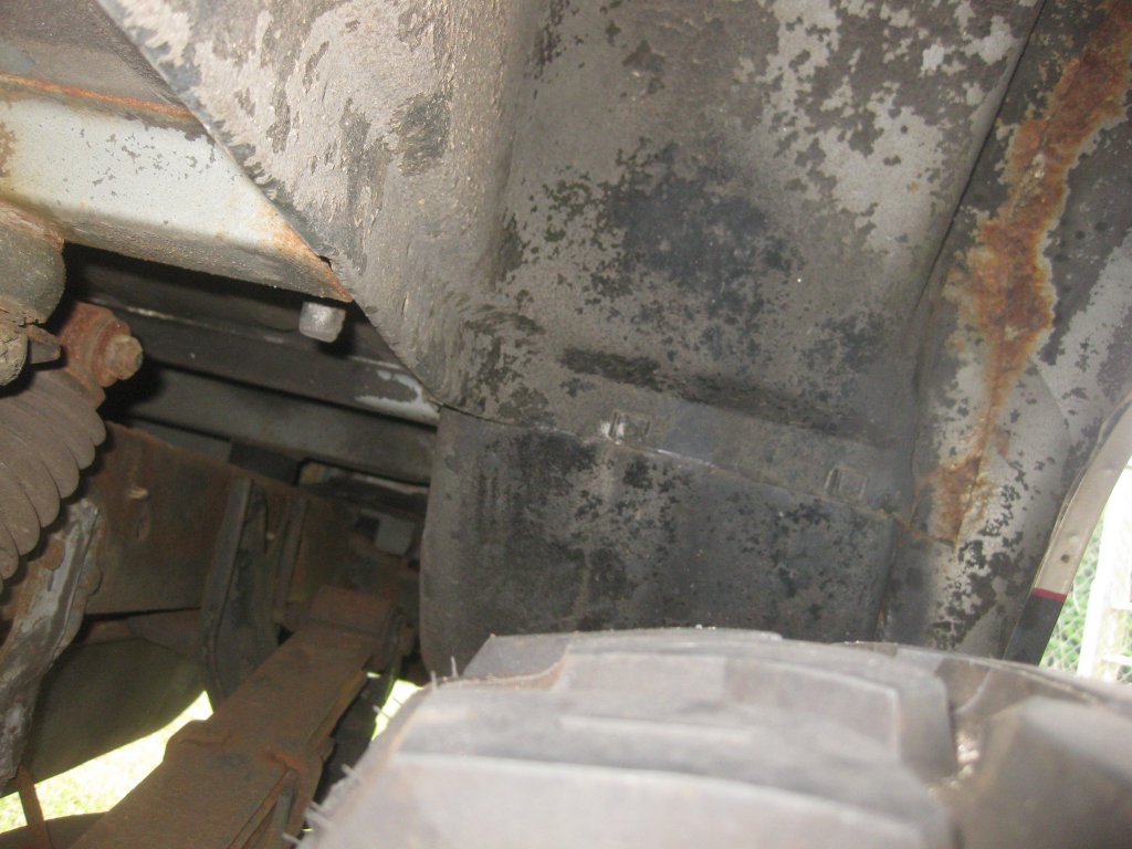

You can see the rot on my suburban's left rear panel. Some say why fix it it is beyond it's life. My response I need the suburban. I don't expect to get it perfect just extending it's life.

Yeah I would rather not give up on the whole rig. The rest of it is very solid and no rust. Just these common spots.
So that part 50076L, how does it fit within the rear fender area. I haven't quite figured out where it would go...and was starting to wonder if using the truck wheel house eliminated the need for that piece.

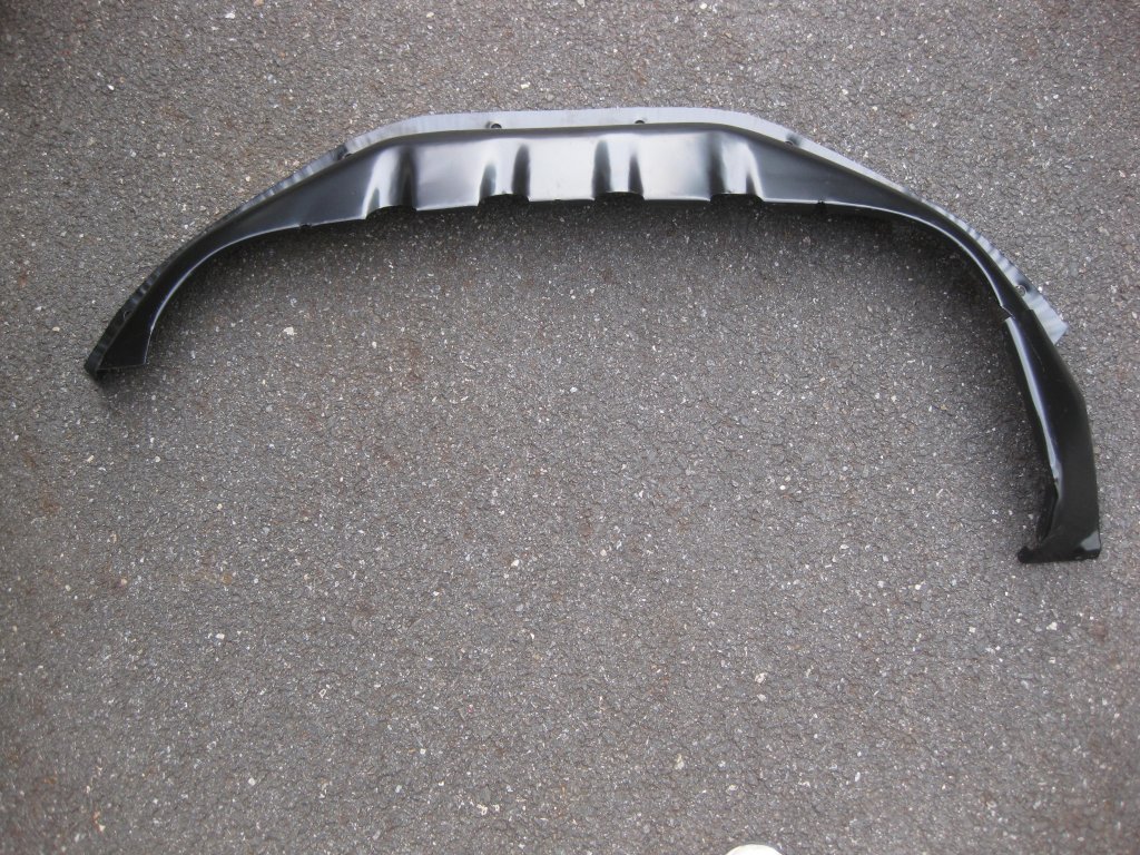

From my understanding the wheelhouse/tub for a pickup is larger than a suburban tub. In an earlier posting there are photos of a pickup tub installed in a suburban. The 50076L fits between the tub and panel. I have attached a photo of a suburban showing the wheelhousing and the outer wheelhousing.
