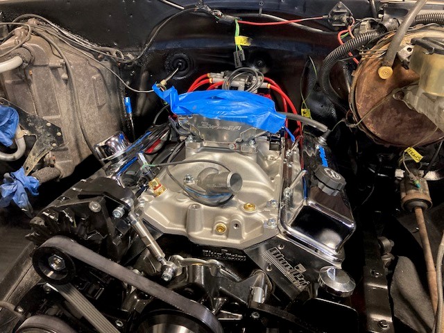

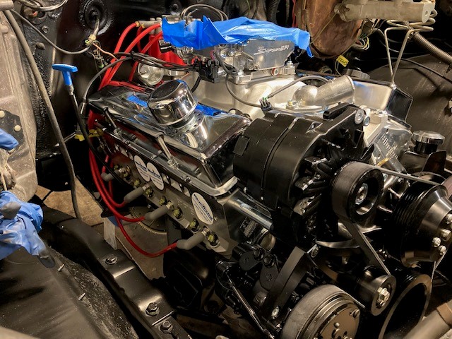

Bummer, Funny thing is I ordered mine from Gabe and seeing they just listed 1 in stock I questioned this. He said their inventory is very accurate and he might be correct, they just sell so many.
Finally mine is at least installed, lots to do though.

Looking good and like mine, Tad.
Trying to source different items to finish it up.
