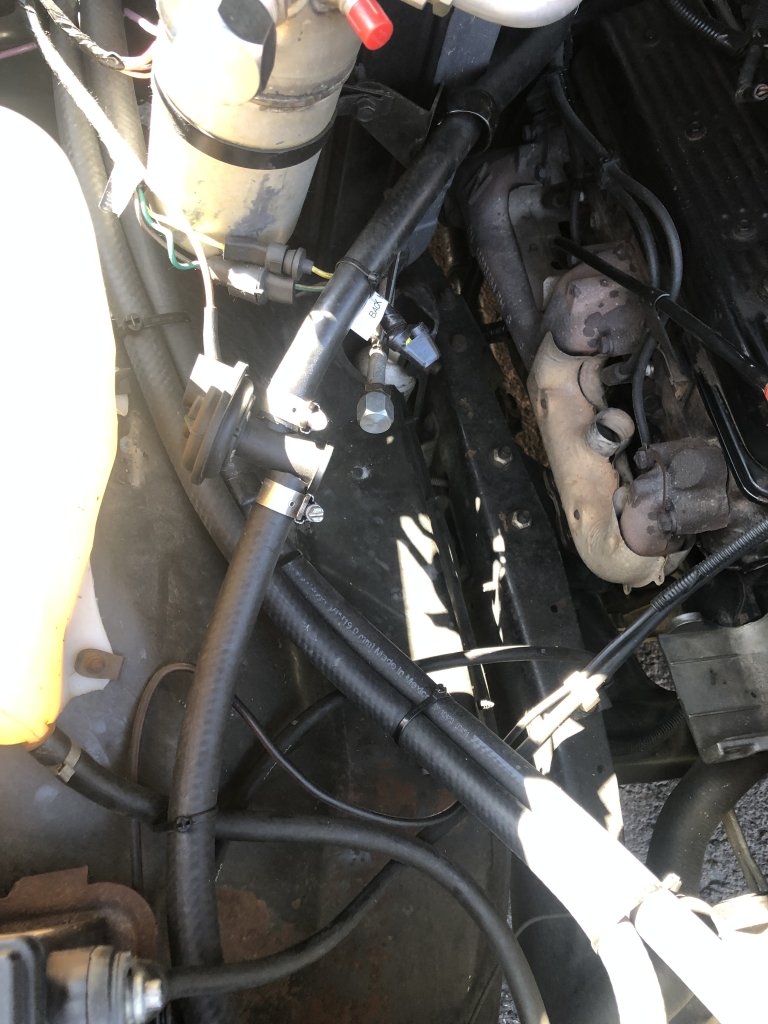

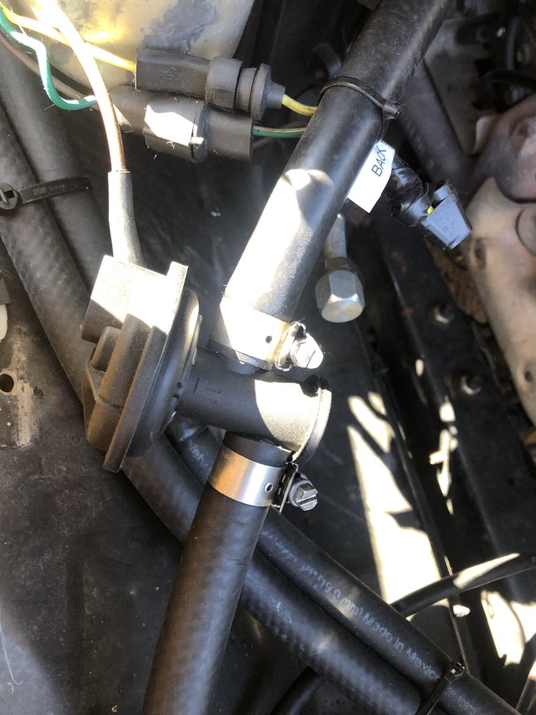

Marine One is that a valve i can purchase or is it all custom work? This is what I Have now Vacuum hose runs off the back heater switch to close the valve. No longer use it. Back heater and AC all gone

Removed the Valve no more coolant leak
Checked all Flapper doors working correct
Still blowing hot air with everything off ?
I Quit mat be time to get the AC rebuilt!
