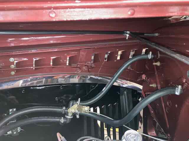

The hard way, Me, I have customers that have complained about a hot heater in the cab as you, and have installed normal heater valves, and just manually shut off by reaching into the engine compartment. I have also put choke type cables to actuate the valve from inside. No problems. Below install in a 41 Chevy AK Pickup

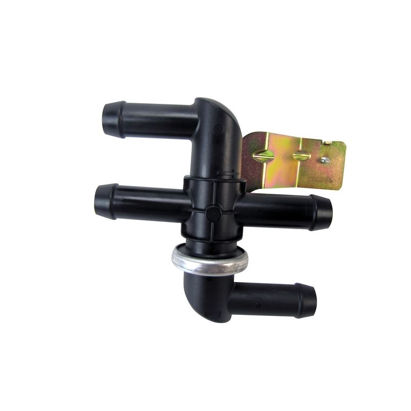

There is a 4-port valve that you can use. It is vacuum controlled so you hook it up to a line that has vacuum when the A/C is on.

I found a vacuum-controlled heater bypass valve, and set it up so when I put the A/C in Max recirculate mode it also bypassed the heater core. Bottom line - it didn’t really seem to make much difference.
I found mention of this valve on this site recently, looks like the valve from a 95 c/k is the one. It has 3/4 and 5/8 inlets and outlets, about $25. No idea on how well it works but it is on my to do list.

You can use one of these, properly sized for your hoses, and operate it manually instead of with a cable.
I used something similar on my 82 C10 that was operated by vacuum. Kinda crude, but I would connect the port to a vacuum hose in the winter, and then disconnect and plug the hose in summer. It made a big difference in the summer. Lots of them on Amazon. You just need to find one with the correct hose nipple size.
