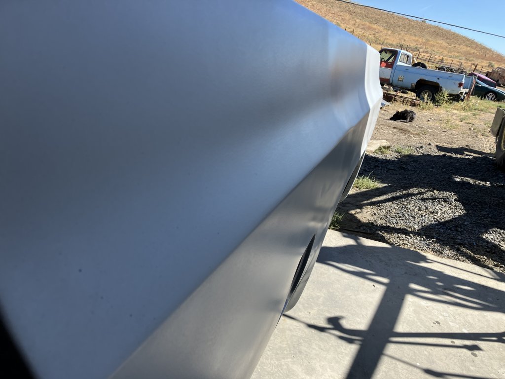

The only person that can't do it is the person that say's they can't do it. Sure you will make mistakes, but you will learn from them. I had a MUCH worse dent than that in my square, took a day or so, but perfect now

without actually seeing the damage the prior posts that suggest a stud puller are worth considering. I have one and it's priceless, just watch your pulling effort.
Not enough reason to cut / weld.
Get the area to bare metal, work the dent, add skim coat, shape / sand / primer / sand / glaze/ primer / sand / paint.
