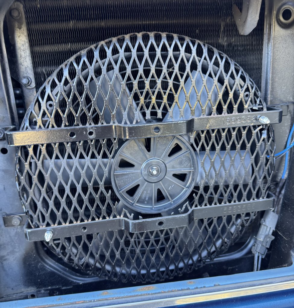

So, the OE auxiliary fan finally bit the dust. Sourced a nice replacement from Summit- made by same company that made the original. Mounted it to the OE cage/bracket easily, cut the connector off the original and soldered it onto the new fan wires.
If anyone needs to replace theirs, this is definitely better than scrounging around the junkyard trying to find one that fits- at least for me. The U pull yard around here has gotten a bit high on the pricing I think.

Do you know what option / scenario dictated a truck getting the auxiliary fan?
Not sure on squares, but in the OBS it was dependent on a 2500/3500 having a big block and towing package. Every now and then I see one come into the yards....but I believe that fan and bracketry is actually available new from Rock Auto. I know it used to be because I was looking into getting it....

As mentioned, pretty sure on Squarebody 3/4- towing package. My truck has the towing package and has both aux fan and oil cooler.
