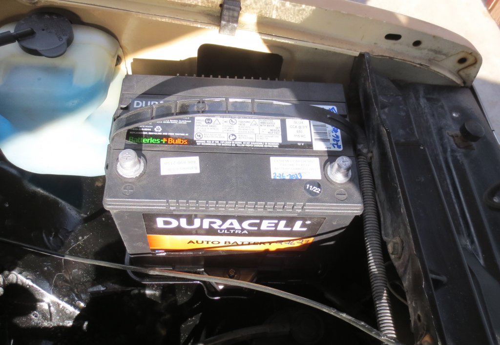

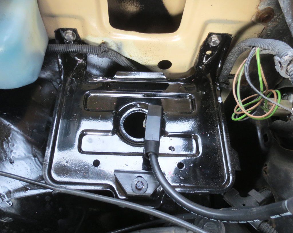

1981 C10 6 cylinder, I installed the auxiliary battery tray behind the driver's side headlight. Screw holes already there. OOPS yours is older than mine:

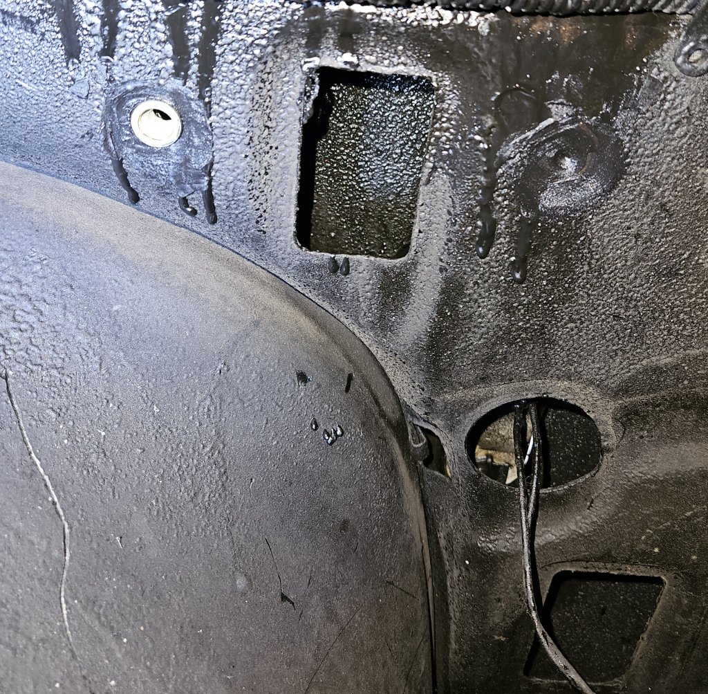

I jumped back on here to say, I found the spot.
I was expecting holes to already be there, but they are not.
There are "dimples" where holes need to be drilled.
I discovwred all of this by taking the battery tray base/support and moving it around the driver's side inner fender until it look similiar to the other tray.
But because there is so much undercoating on everything, the dimples were not obvious. Had to sorta dig for them.
