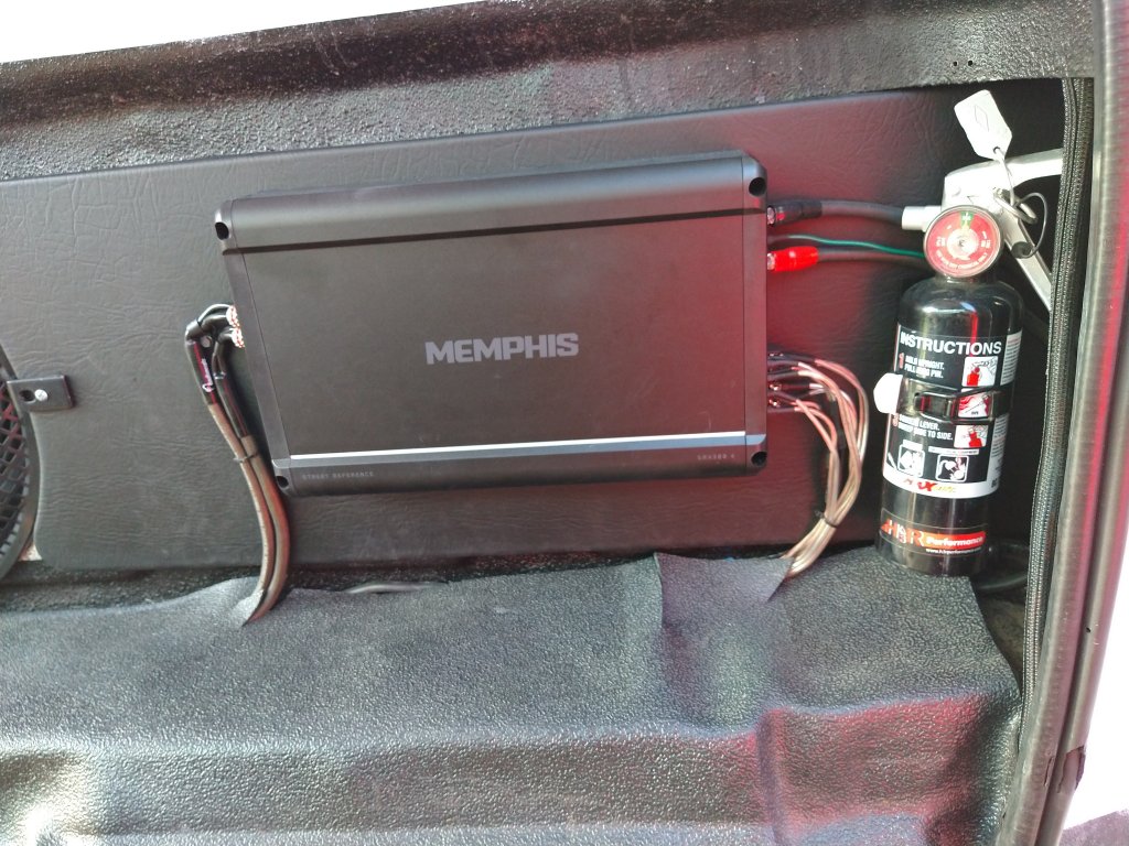

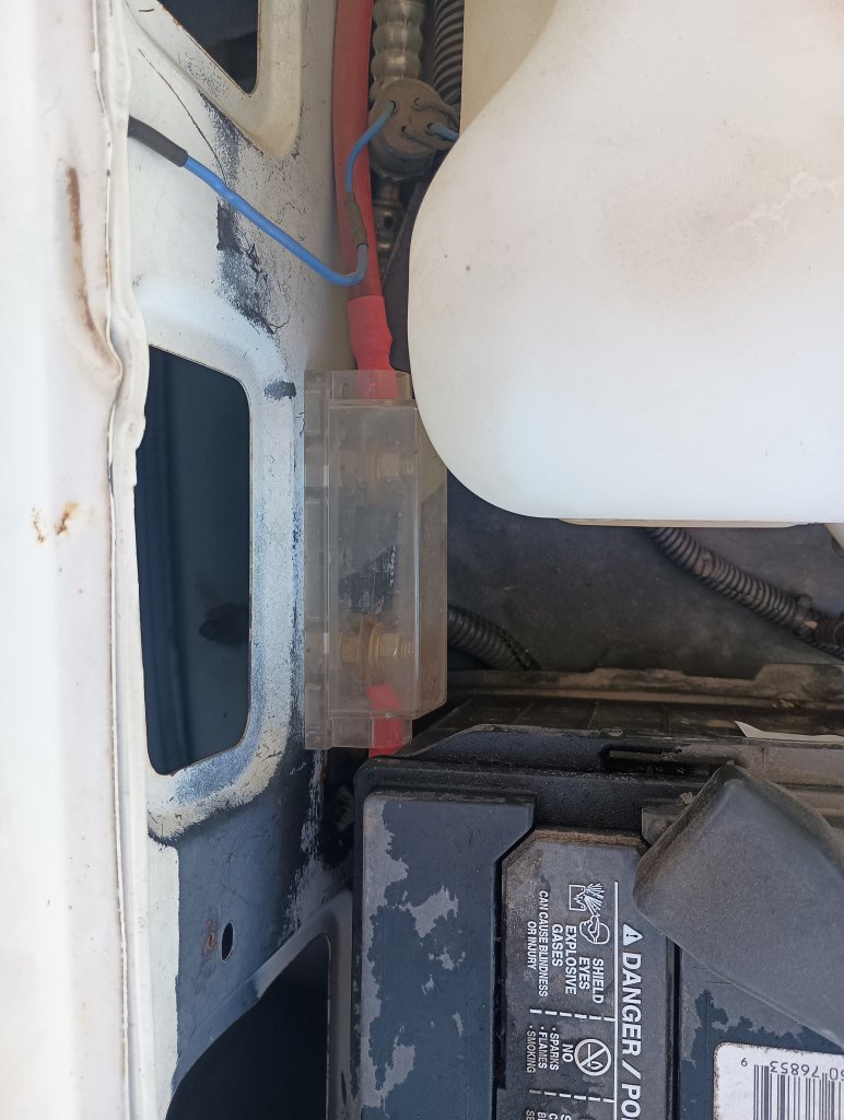

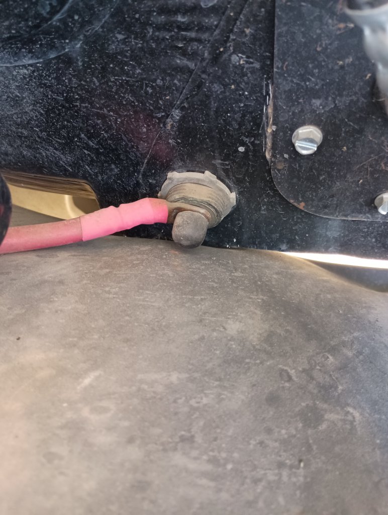

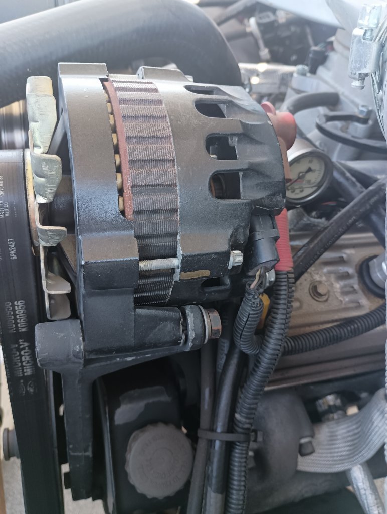

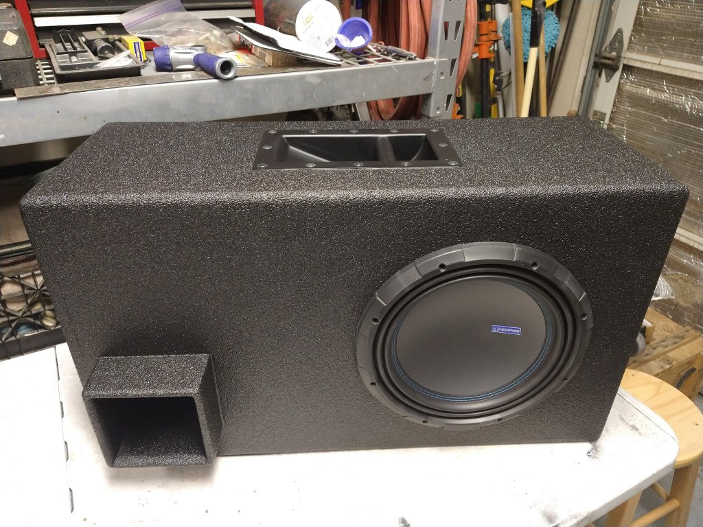

What are you trying to accomplish by installing a second battery? IF it's just for the purpose of running two amps, why do you think you need two batteries? I'm just probing you on your knowledge of audio equipment. I have put together probably over 200 systems over the years and I know a bit about them. Not everything, but enough. Can you post what amps you are using?

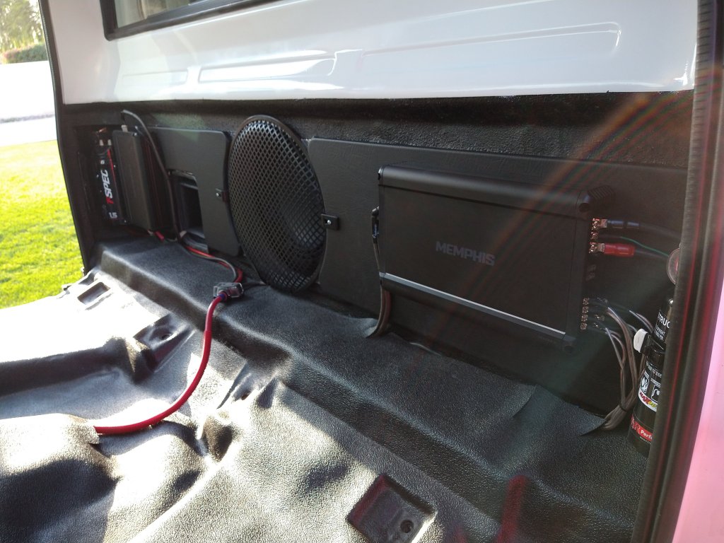

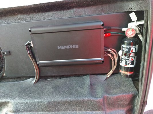

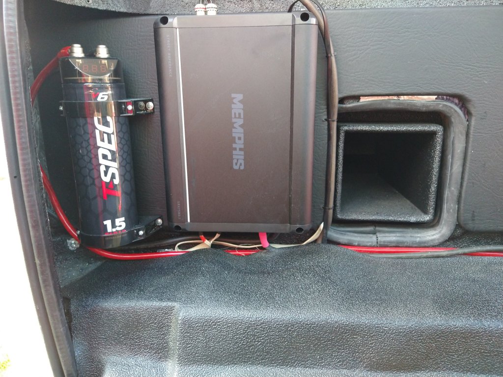

That's what happens when one jumps to the latest post. A good battery and alternator will suffice for 99% of any system one could put in a Squarebody unless your a nutcake and have blow thru subs in the bed. Now if the second battery was intended for other accessories that might be used in a camper type scenario, I could understand the hassle and expense of a dual battery setup.
I'm pushing 1900 RMS watts like it doesn't know it's there. PowerMaster 150 amp alt, 4 gauge charging wire (welding cable) and 1 gauge feed cable to the amps. It might sound like overkill but it's a once and done with room for increased capacity (wicked me has some idears). To each their own but be aware of those Rabbit Holes.
